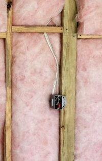

Well... I would fail it because they did a terrible job installing the insulation.
Vapour barrier needs to go on the side of the assembly with high moisture drive. In our climate (cold/dry) the vapour barrier goes on the other side (inside) of that wall. In Florida (warm/wet) vapour barrier would need to go on the outside of the wall assembly.

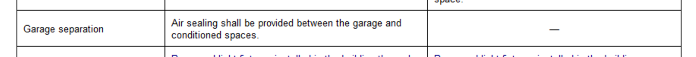

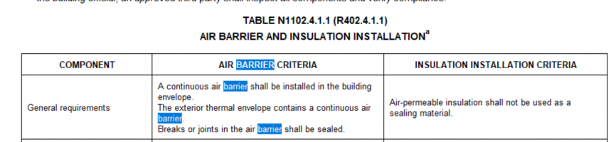

A vapor barrier is not required only an air barrier between the house and the garage.
AIR BARRIER. One or more materials joined together in a continuous manner to restrict or prevent the passage of air through the building thermal envelope and its assemblies.
The IRC requires R-13 not R-11 so it is a fail.

Some jurisdictions require the insulation to be cut out around the outlet boxes.
