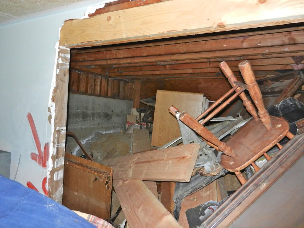

This is a back wall of a garage with a two story condo above. The second floor burned up. When I got there, the garage door was open. Had the door not been open, I might not have ever seen this. The owner blew out the wall for access to the underfloor area for storage.
The second floor was a total loss and the owner wanted me to release the electrical service to Edison so the tenant could move back in. Gas co. too.
