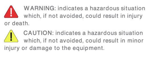

Tesla has two warnings related to sunlight. The level of warning is a caution due to minor injury or damage to the equipment. The information is not presented as a recommendation. I wonder what Tesla considers a minor injury or damage. I have no issue with enforcing the caution as an installation instruction and therefore, code..
1) The lengthier section I quoted clarifies the terser Caution you quoted. It makes it clear that the issue is possible equipment damage, not safety. As such, I don't see it as enforceable at inspection.
2) I see "Avoid X" as a recommendation, and not the same as "Do not do X".
For example, we have the Red Warning that says "WARNING: Do not expose Powerwall to ambient temperatures above 60°C (140°F) or below -30°C (-22°F)." Compare that to the Yellow Caution that says "CATION: Avoid installing the Powerwall and Backup Gateway where it will be exposed to . . . ambient temperatures greater than 35 deg C." The former is an absolute requirement, enforceable at inspection; the latter is just a recommendation.
