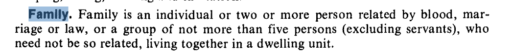

I believe you are correct and that is why you no longer find a definition for "Family" within the building codes. Family was defined within zoning codes and most of them when challenged on the definition have lost over the years.
1983 CABO definition
1979 UBC
