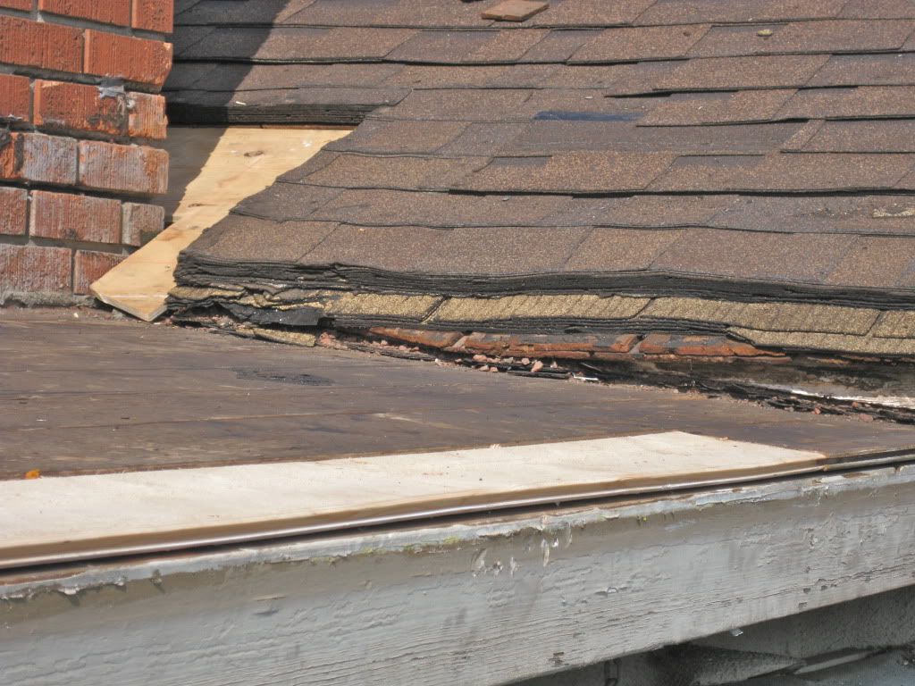

This might be a record
13,902
What your supposed to seperate the tose things?
Honest i thought they wrapped shingles individual like kraft sandwich cheese slices!!!!!!!
No wonder the dam**ed nails were so short
HOw many Squares did you say 800 on a 20 x 20 building
of course its a twelve pitch OK
I don't think it's a record. My next door neighbor had SEVEN layers of roofing on some areas of his roof. One area had skip sheathing with hand split shakes, roll roofing, felt, and shingles layered and layered and...
Poor house sighed with relief when the roof was stripped off.
I wonder if the roofing company that gets this job charges per layer on the tear-off? Insurance only paying for half a roof I bet?

Looks like a few here. The best I know of though only had four layers - one wood shake, one wood shingle, and two comp. That sure was a mess to strip off. I could hear the house sighing with relief....; )
I worked on a house once that had asbestos cement tiles over rotten cedar shakes on skip sheeting. As soon as you put any pressure on the roof, the tiles would crack. ugh.

Correct me if I am wrong but does the code not place a limit on the number of reroofs. If wood trusses were used it is almost a guarantee that the current dead load exceeds that assumed in the truss calculations.
R907.3 Re-covering versus replacement. New roof covering shall not be installed without first removing existing roof coverings where any of the following conditions occur: Where the existing roof has two or more applications of any type of roof covering.

You may not be able to put two layers of roofing?
See 2006IRC R907.3 (4) requires that the old roofing be removed down to the sheeting, if your town is in a moderate hail zone. see map 2006IRC R903.5 to see your county's hail exposure. Changes have been made from the IRC2003.
