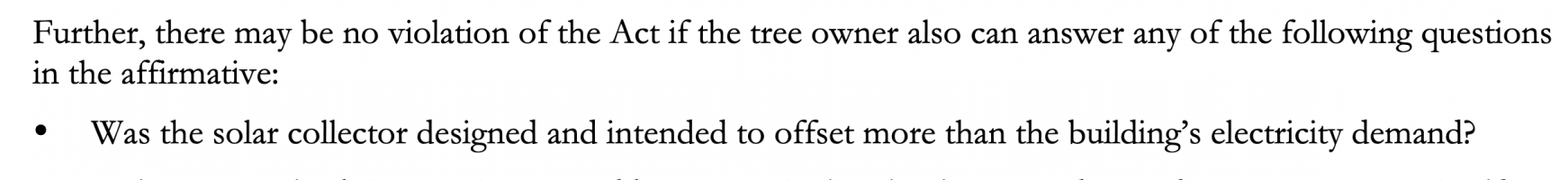

The paper explains the law with regards to shading solar collectors. On page nine there is a series of questions that when answered will indicate if there is a violation of the Act. The following screen shot is from the list that an owner of a tree can use to determine if a violation of the Act exists.
That is the single mention of this in the document and I found no mention of this concept in the Act. It is possible that I missed an explanation of "offset more than the building's electricity demand" however, that's a barn door open for interpretation. Nearly every residential system is intended to send power to the grid when the onsite demand falls below what the system produces.
I lack insight for a followup to that.
One thing made clear is that the Act does not apply to trees or shrubs that predated the installation of a solar collector. There are hurdles to be dealt with such as a timely written notice to the neighbors but implementation of the Act is straightforward.
