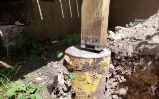

From an instalation lack of mess, and labor stand point I like the helical screws.the execution by the carpenters not aligning the beam splices doesn't matter what post you use, they have to be over the support, and not adjusting the saddle up to the beam is unfathomable.
How long will the welded steel last in the ground compared to galvanized?

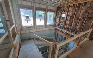

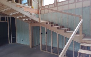

I dug up some pics you might enjoy. Portal frame anchor bolts that weren't there the day before (mentioned in another thread). The white stuff is "great stuff" that stayed on the bolt when I pulled it out of the plate. Every bolt in the garage was like this.
This was how they decided to resolve the inspection failures. They had a toddler.
