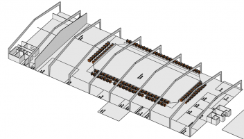

I am working on a Roller Rink. At the concept design level.
It's 130'x430' fully sprinkled roller rink with a separated banquet hall. I have a program and code analysis that generates over 2k occupants. It is an A-2 Assembly occupancy. I am coming up with 14 male and 26 female toilets, that's a lot. I think more than I have ever seen even at the stadiums, airport or highway rest stop.
Can I share my program and calculations, looking for a silly math error or a code reduction I am not aware of.

Ok.. taking a look at what you have, what stands out to me is the OL for the "Circulation" area. Now, without seeing the plan, I am somewhat guessing... but something appears off when I am seeing that the OL of the circulation area exceeds that of the skate floor.
Agreed. Circulation is what remains when I subtract all the other spaces from the total building size, a pre-engineered metal building, 130'x430'
Rink has fixed seating around it. Banquet at the top of the picture.

Fixed seating should be calculated per IBC Section 1004.6 (below). This may help drop the OL for the circulation area quire a bit.
1004.6 Fixed Seating
For areas having fixed seats and aisles, the occupant load shall be determined by the number of fixed seats installed therein. The occupant load for areas in which fixed seating is not installed, such as waiting spaces, shall be determined in accordance with Section 1004.5 and added to the number of fixed seats.
The occupant load of wheelchair spaces and the associated companion seat shall be based on one occupant for each wheelchair space and one occupant for the associated companion seat provided in accordance with Section 1108.2.3.
For areas having fixed seating without dividing arms, the occupant load shall be not less than the number of seats based on one person for each 18 inches (457 mm) of seating length.
The occupant load of seating booths shall be based on one person for each 24 inches (610 mm) of booth seat length measured at the backrest of the seating booth.
It reduced some. Less circulation area. There are 102 tables with 8' of bench ( 4-person) each.

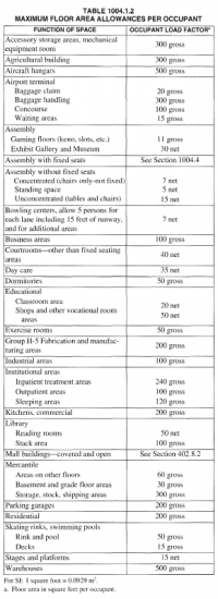

Your occupant calculation includes 237 people in the restrooms and another 27 in the Banquet restrooms. I know certain demographics sometimes have a habit of congregating in restrooms but net area specifically excludes them (at least in the Florida Building Code, which is based on IBC, does):
FLOOR AREA, NET. The actual occupied area not including unoccupied accessory areas such as corridors, stairways, ramps, toilet rooms, mechanical rooms and closets.
But... I believe your outdoor dining needs to be part of the restroom calc. Don't have time to check that at the moment so could be wrong.

I agree with you at least in principle that it is unlikely that people congregate everywhere at the same time, including toilet rooms and mechanical spaces. However, my read of the IBC table I am using has gross area identified for the deck area around the rink. I want to be wrong. In electrical design there is a way to factor down the total added load to a likely working load (not all appliances are turned on all at the same time). Is there anything like that for occupancy?
What I was alluding to is you calculated the restrooms at 1/15 as if they are assembly spaces, however they are not. Remove the 264 people in the restrooms from your calc and your fixture count will be closer to what you are looking for.
The deck and rink may be gross but that doesn't make every space gross. Similarly, your building use may be assembly but that doesn't mean every space is to be calculated at 1/15.
The outdoor spaces should be included in your area calc's too and if you have separate facilities for those spaces then they should be included in your fixture, assuming they're within travel distances, etc.
