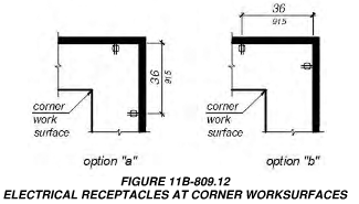

I know that many CASPs and accessibility experts utilize the "Handbook of Construction Tolerances" by David Kent Ballast to determine compliance with absolute dimensions in the code. I have the 2nd edition, and it has no I don't see any tolerances listed for plumbing or electrical components.
How much construction tolerance would you allow for these two absolute dimensions:
1. The Fair Housing Act Design Manual (pages 7.43-7.45) requires exactly 18" from side wall to centerline of toilet. (Yes, I know ADA is 17-19", CBC is 17-18", but I'm also trying to comply with FHA.)
2. CBC 11B-205.1 exc. 9 and 11B-809.12.4 both require an outlet placed exactly 36" from inside corner of work surface (counter):
1/2" personally, at least for my inspections. It's next to impossible to get things exactly where we want them, especially when code is unnecessarily strict (in my opinion). I bet if you look close enough, you could prove that any water closet installed that needs to comply with the FHA is not exactly 18" off the wall.
Whichever is the most stringent. I worked with David Ballast on the tolerance book. The ADA says it recognizes standard industry tolerances which was never published anywhere we all knew it to be 1/4" up or down. The figures you show for countertop receptacles were also in the Fair Housing First illustrated manual, but that manual is not compulsory or required. I have seen a lawsuit for the toilet at 1/2" off center not an eight or quarter yet.
The illustration I provided was from the Fair Housing Act Design Manual, not from Fair Housing First. Isn't that one compulsory / required?
