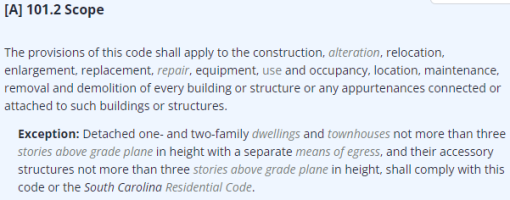

Any other building that does not meet the definition above (such as containing 3+ dwelling units) = South Carolina Building Code.
https://up.codes/viewer/south_carolina/ibc-2021/chapter/1/scope-and-administration#101.2
Excerpt form 2021 SCBC:

That would be different from any jurisdiction I have built townhomes in. The number of townhomes does not change which code you're under. Townhomes are single family attached. You can have 12 townhomes all attached and still be IRC. If you don't meet the definition of a townhome (at least two sides open to yard or public way and no stacking) then you are R-2 under IBC. You're ignoring the "and" in front of "townhouses" in the exception.
One billion attached townhomes, still IRC.
Ah, coming back to sentence structure yet again:
Adding commas and words to help under stand our two different perspectives as to what nouns are being modified by the word "detached", redeyed fly, you are reading it as:
  • Detached one- and two-family dwellings, and townhomes not more than three stories above grade plane...
I 've been reading it as:
  • Detached one and two-family dwellings, and [detached] townhomes not more than three stories above grade plane...
And in context of the IRC requirements for separation walls where each townhome is structurally independent, with independent fire ratings, I am now inclined to agree with you that the intent of the code is that a billion townhomes would still be IRC.
