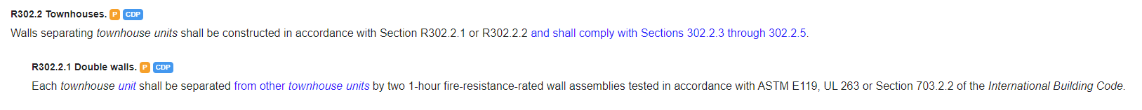

I think the subject of townhouse wall continuity has reached a point of Frankenstein that it's time to consider a total revision of the sections. (not the applications, just the presentations) Let me explain.

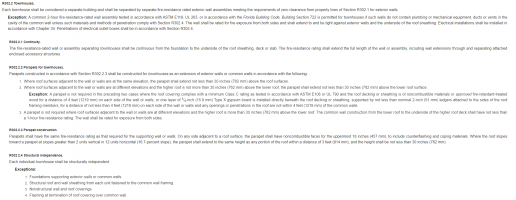

R302.2.2 common walls: Has provisions for the common wall to extend to the underside of sheathing and exterior walls. A new exception was added in 2021. But isn't that why we have the next section.
R302.2.3 Continuity: These provisions are for both common and double wall, but refers to "the fire-resistance-rated wall..". It basically repeats much of what is the section above, but adds a few more details about attached accessory structures.
R302.2.4 Parapets for townhouses: Now we learn that the above two sections only work when you use the exception from this section. Here we learn the general rule is the "common wall or exterior wall" (does that mean "double wall") actually can't stop at the underside of the sheathing, and really has to extend through the roof. Oh but wait... there is an exception that does allow you to terminate it under the sheathing.

Maybe look at it this way??
302.2.2 refers to a common wall as a specific entity with specific properties and restrictions, and maybe would be better titled "single wall".
303.2.6 refers to a generic entity and would apply to either "double walls" or "single walls", and maybe as you say, be better titled "separation wall".
But I think this section has always been a mess.
That's exactly how I look at it. But since it quite clearly uses the words "common wall" in those exceptions I want to get more consensus that "The words are wrong" Thank you for sharing your thoughts.
