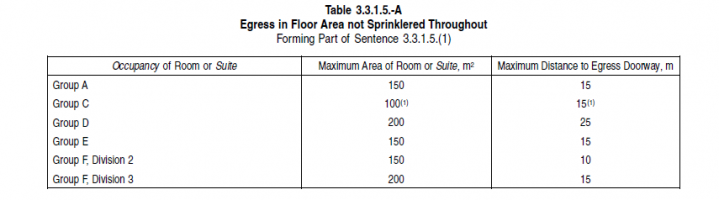

travel distance to egress doorway and to exit
sunyaer
Apr 21, 2022
338
Toronto

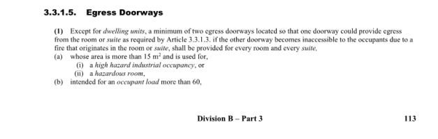

These are from Ontario Building Code, Division B.
It looks like 3.3.1.6. is useless, as the travel distance to the nearest exit would be always longer than the travel distance to the egress doorway, unless the egress doorway is the entrance to the exit, where the travel distance to egress doorway equals the travel distance to exit. In the opposite way to say it: the travel distance to the nearest egress doorway by no way would exceed the maximum travel distance specified in the clauses 3.4.2.5.(1) (a), (b), (c) and (f) for exits, then why is clause 3.3.1.6. needed?

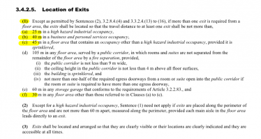

I think I see where the confusion might lie. Note 3.4.2.4(2) which allows travel distance to be measured from the egress of a room or suite in certain conditions.
This is most likely going to be the case with apartment buildings or office complexes served by fire-rated public corridors.
Let's throw this out there:
So, as an example, in an office building, a 195m2 room that meets certain requirements (say a fire separated room - 3.4.2.4(2)(a)(i) ) can have a travel distance of 25 to an egress doorway in a fire-rated public corridor. That resets the "travel distance" for exiting to 40m *from that doorway* (per 3.4.2.5). So the total max travel distance to the exit would be 65m.
In an apartment, unsprinklered, fire-rated suites and fire-rated corridor - 15m to the corridor from within the suite then 30m from there to the furthest of two required exits [3.4.2.5(f)] would mean 45 total maximum distance.
In a sprinklered office building, that would be 25+45. I'll let you delve into the codes/tables to figure out how that number was derived.
