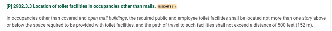

Per Ch 29 of the IBC the prescribed distance to travel in a factory setting is 500 feet or approved distance by the AHJ. Is it the intent of the code to have the path completely indoors or can an exterior path comply as in a campus type setting?
