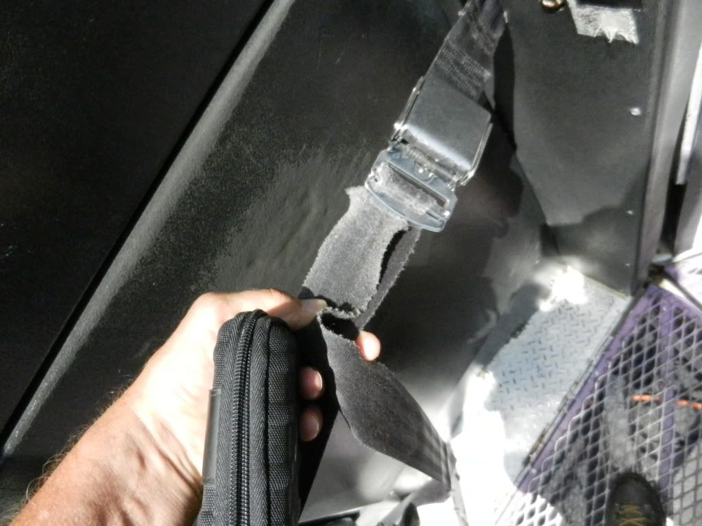

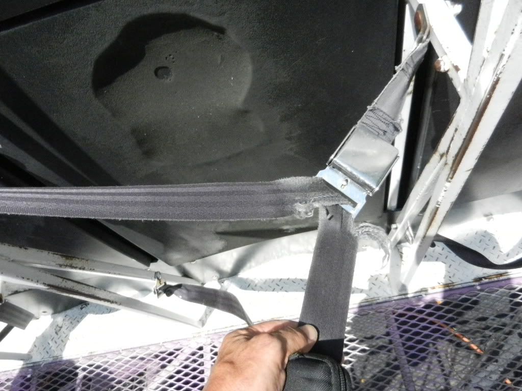

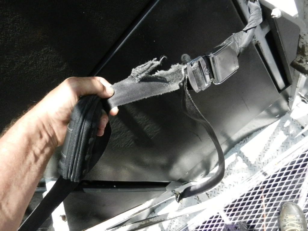

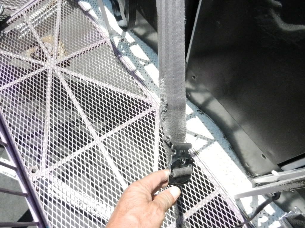

The restraints apparently passed a recent state OSHA inspection as did all of the rides at this carnival.
The operator wasn't able to replace the restraints so faulty restraints were removed and the position disabled. A corresponding position was removed on the opposite side of the ride to maintain balance. With all the possible juggling of the safe restraints that were available, 10 positions were disabled.

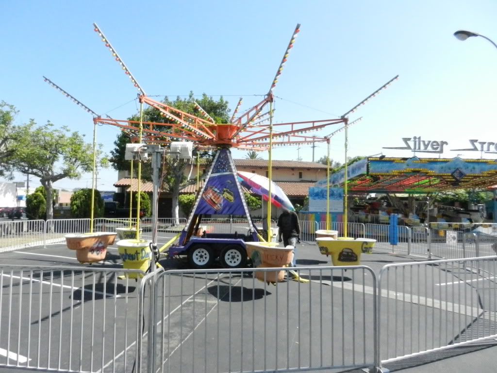

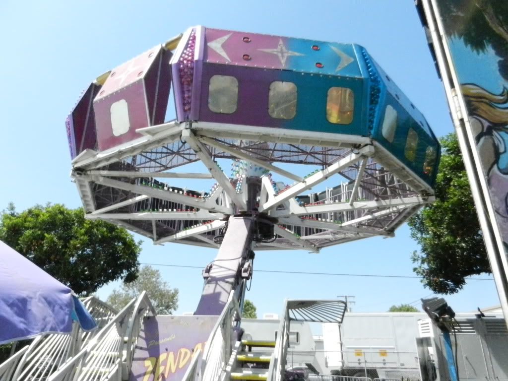

This little gem is the Mind Winder.
It is a "kiddie ride".
This thing hits >15 RPM.
The basket is >45 degrees.
They ran it too fast and it shut itself off.

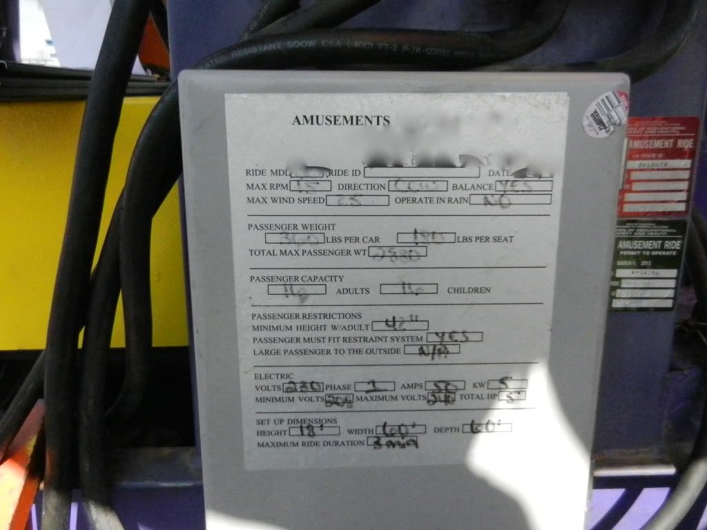

The placard mounted to the machine says 15 RPM. I stood back and thought that this is just wrong. It was scary to be near the thing at full speed. The weight of the tubs and passengers spinning around what I think is an inadequate machine bothered me so I called the state OSHA carnival office and found out that 10 is the max RPM.
The correction read " The maximum RPM of 10 can be exceeded. Do not operate without a device that shall limit the maximum RPM to 10. Said device shall be hardware that shall require the use of a tool to remove."

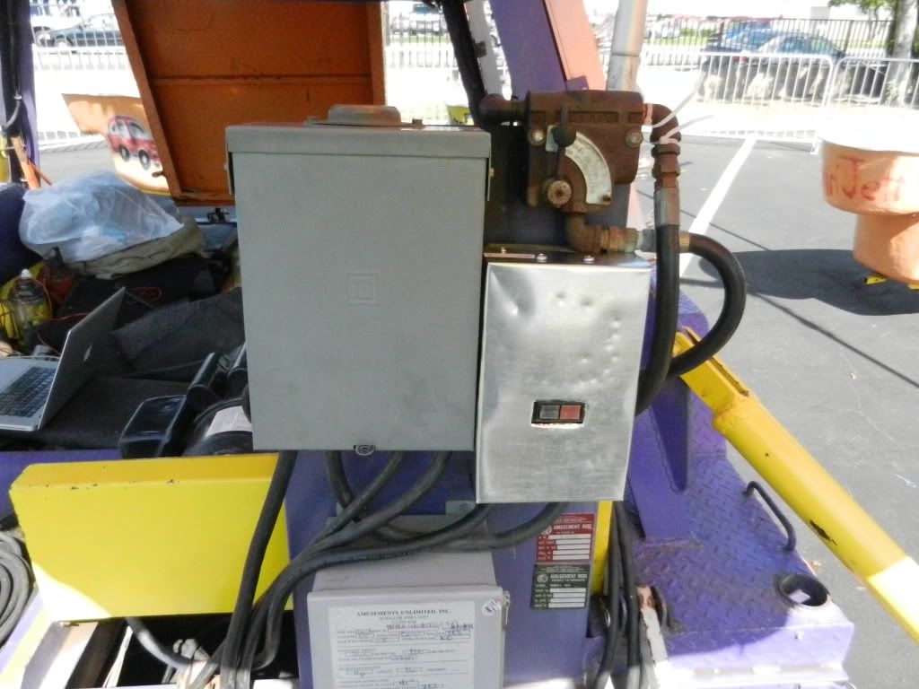

The tin cover over the start/stop switch is the result of a correction. There had been a Plexiglas cover and the correction said to restore the UL listed cover or replace the switch enclosure. When I saw this they said "What? You said to replace the cover".

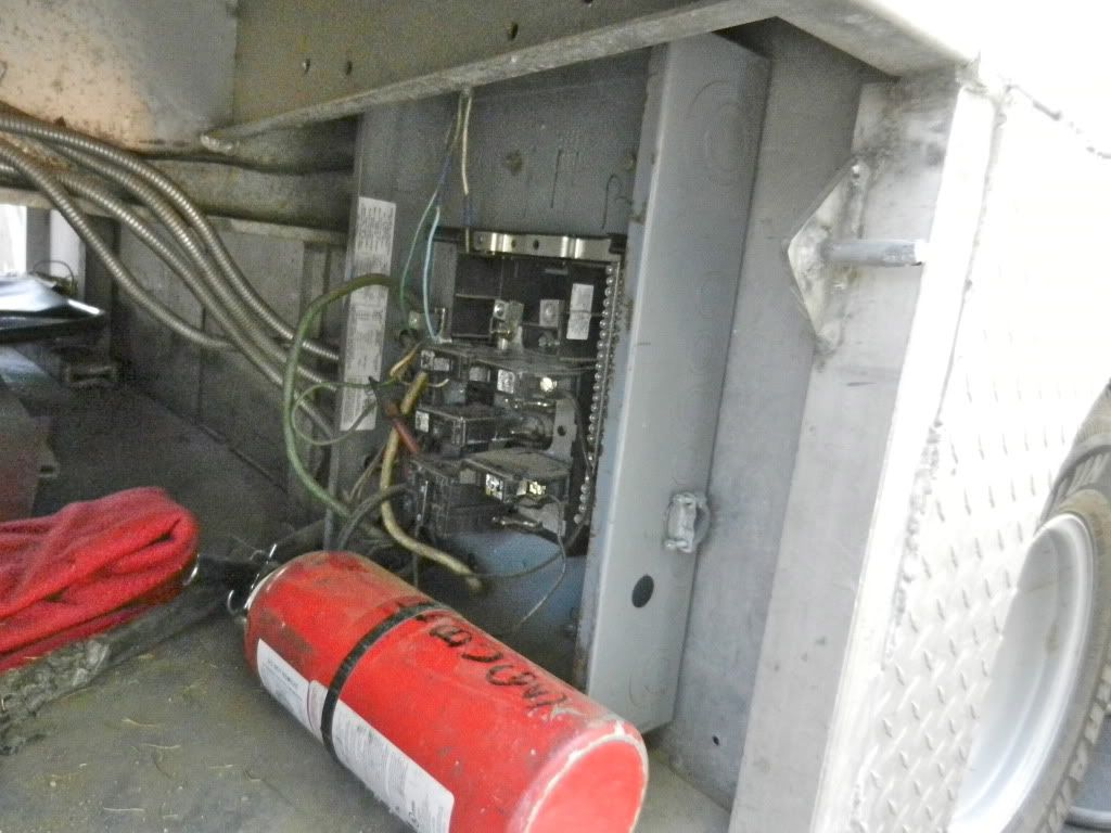

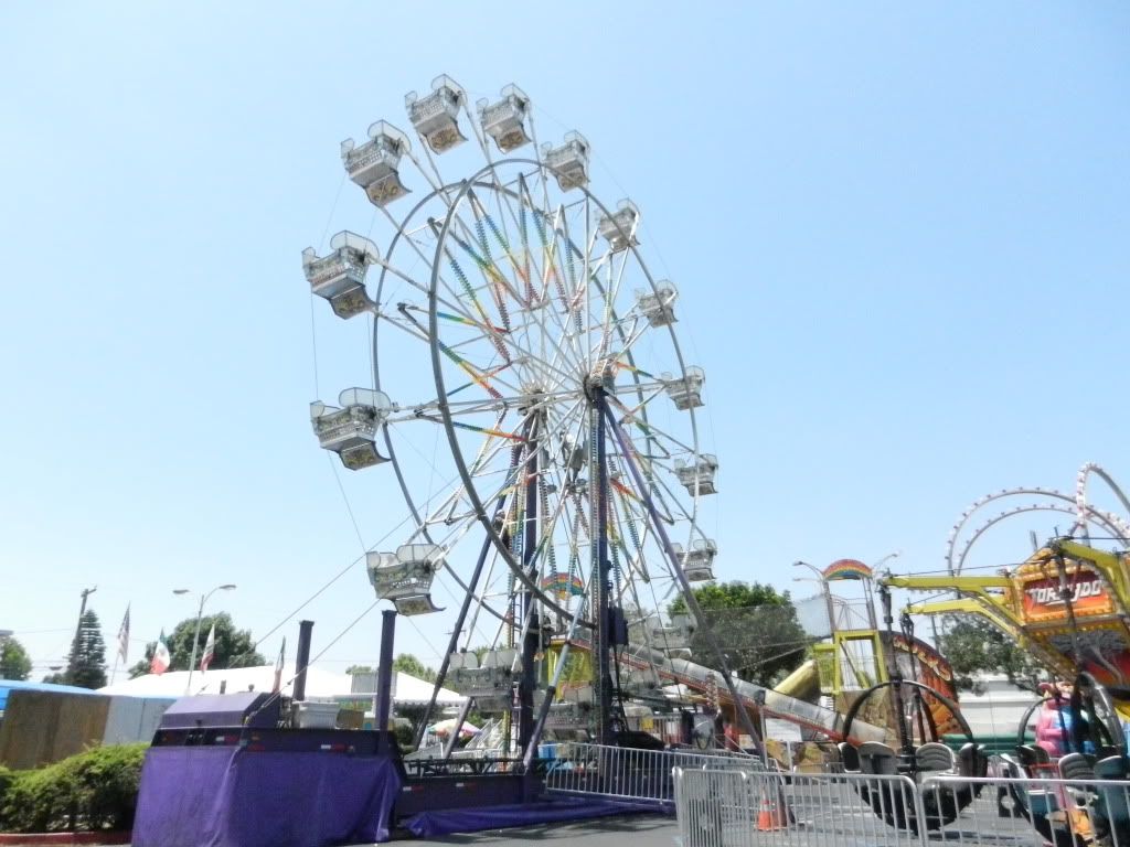

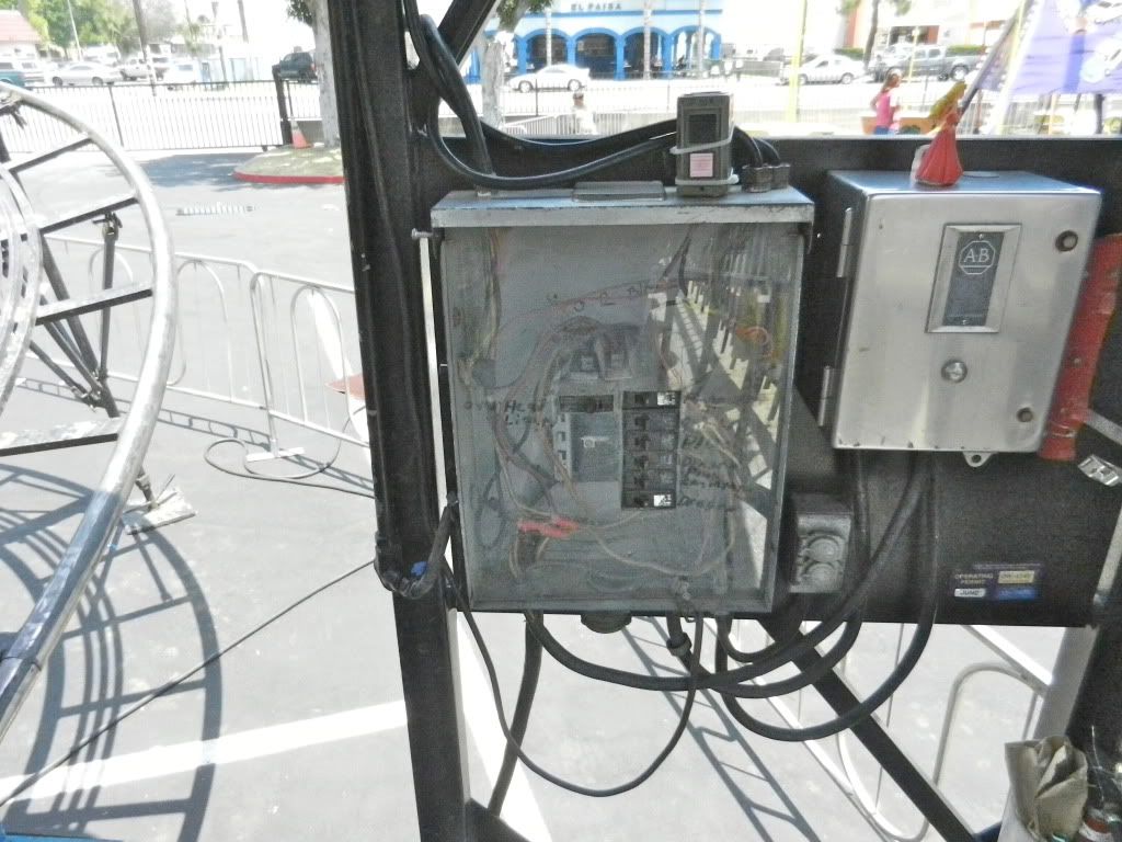

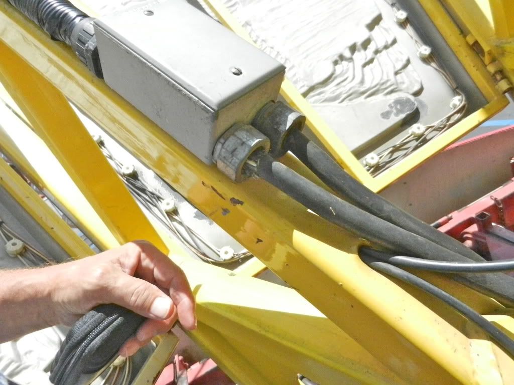

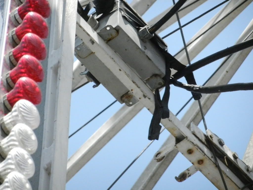

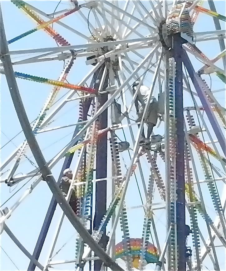

There are about a dozen of these boxes high up on the ferris wheel.

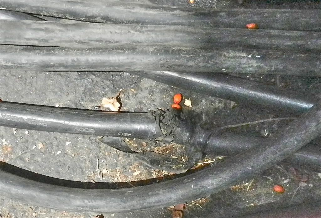

Held together with tape. The taped cable at the right is emblematic of the entire carnival. There is enough neglected maintenance to keep them busy for a long time.
Been on fire.
Later on I came upon the repair in progress.

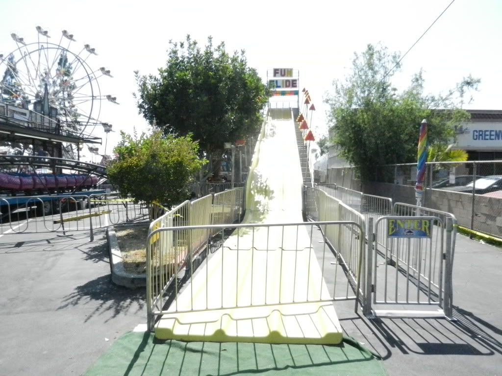

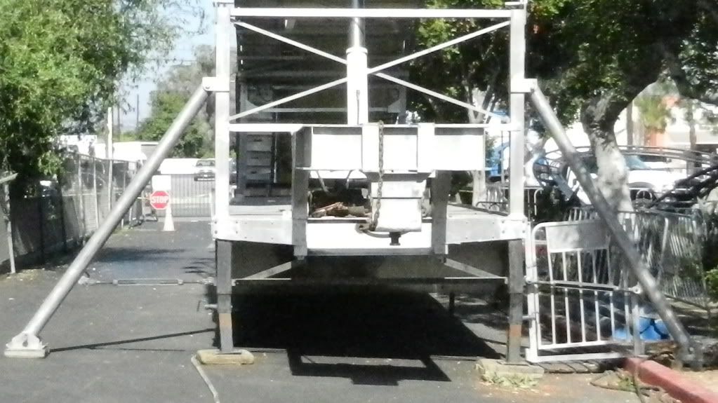

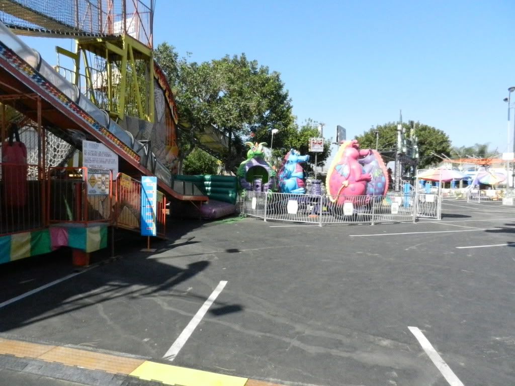

The slide isn't regulated by the state or any other agency because it is not a mechanical device. Then why am I here and what am I supposed to do? The last time I was in a training class on carnivals was never.
Could someone remind me to check the legs on the next slide that I come across.
You want to light up the slide to enhance the experience.
The problem.

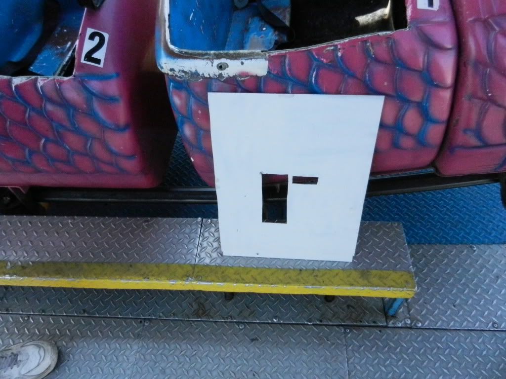

They thought that white paint is a remarkable improvement on clear Plexiglas.

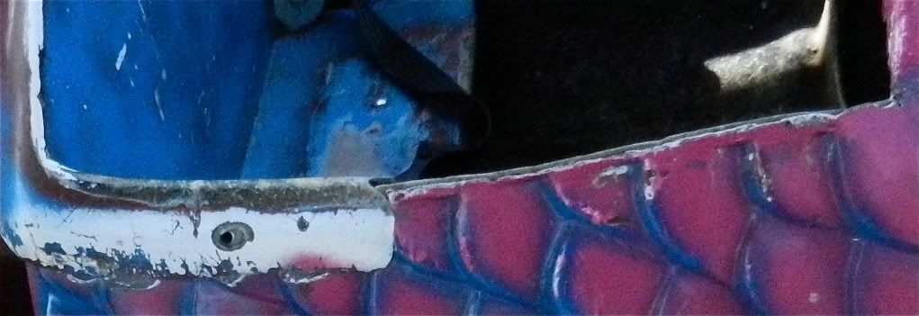

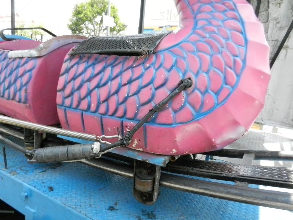

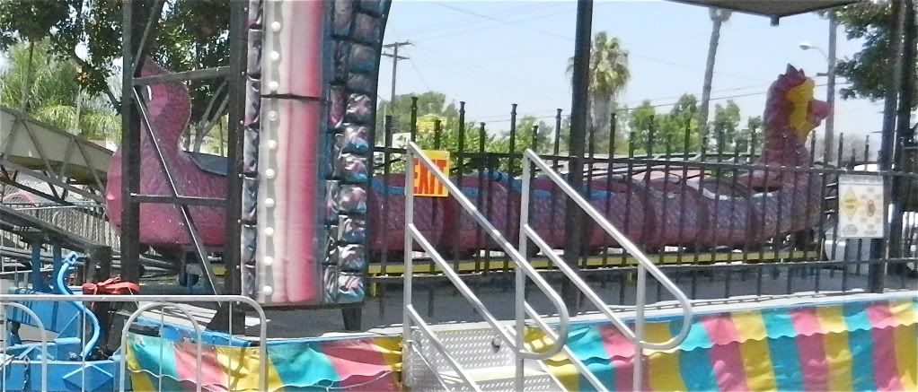

The ride is a Dragon Wagon.
Every car has sharp edges just waiting to give some little kid stitches.
Years ago I saw a 20/20 report on a Florida girl that was sitting in the car ahead of the motor car. Her long hair was caught up in the mechanism and she was permanently, entirely scalped. And how about that power cord.

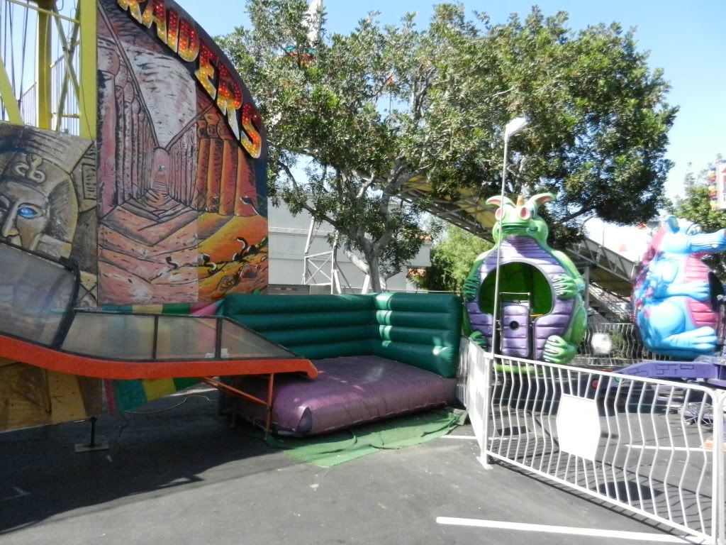

30 minutes before opening time, the slide landing pad was inflated.
It pushed the fence against the ride next to it. The operator had no clue until I told him.

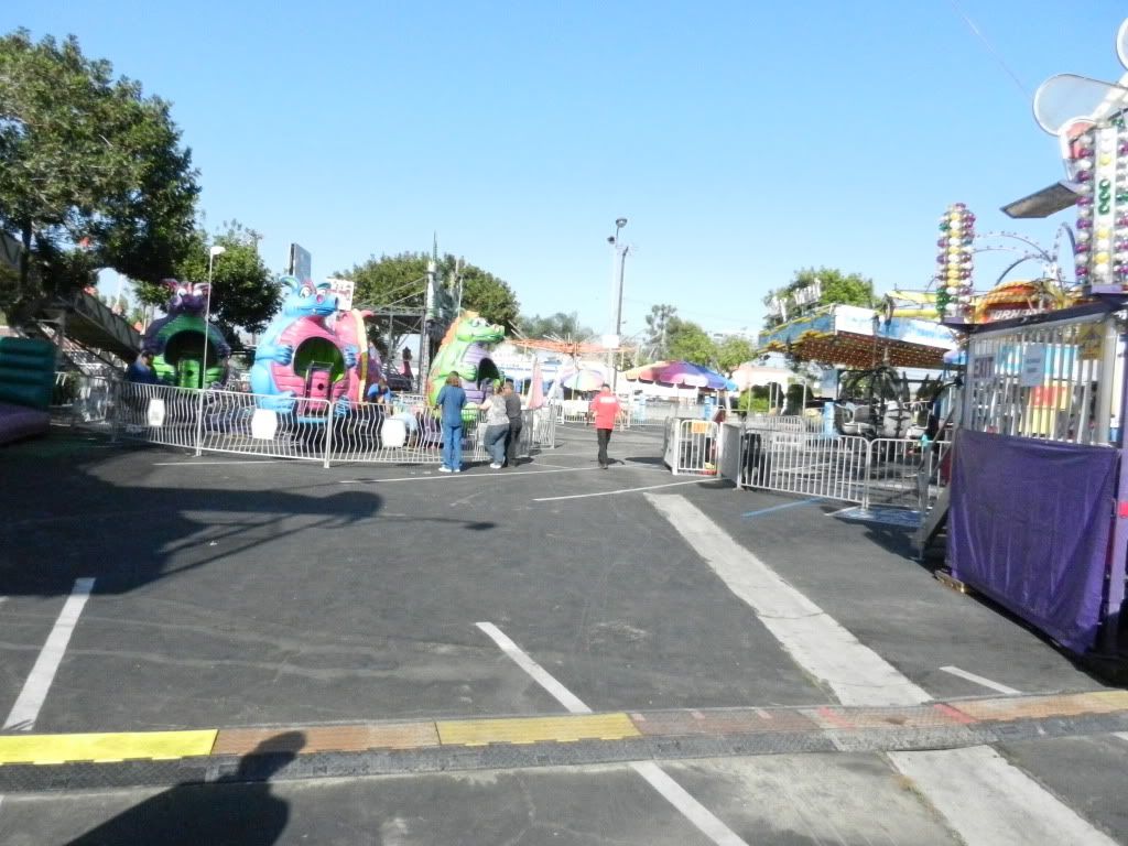

The Dizzy Dragon was drug 12 feet across the parking lot with a truck.
Now the midway is reduced to 10 feet.

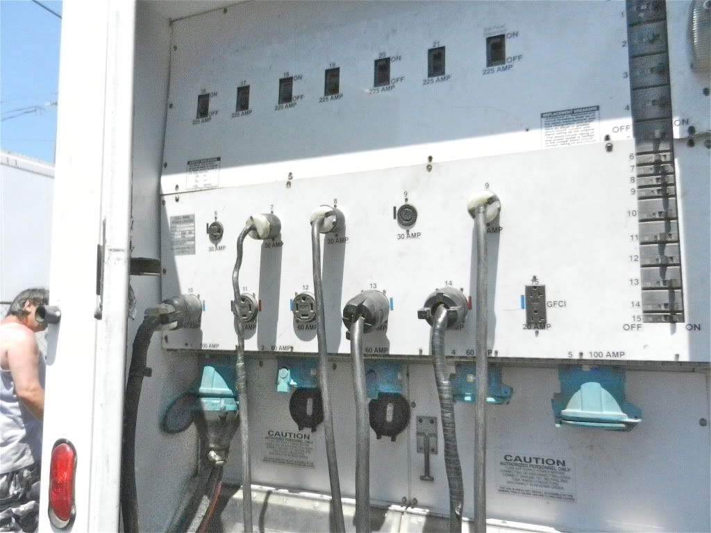

Everywhere you look, there is a problem with the electrical.
Or is it that I am the problem?
After all, these rides have been all over California and used with the blessing of the State and countless loco jurisdictions.

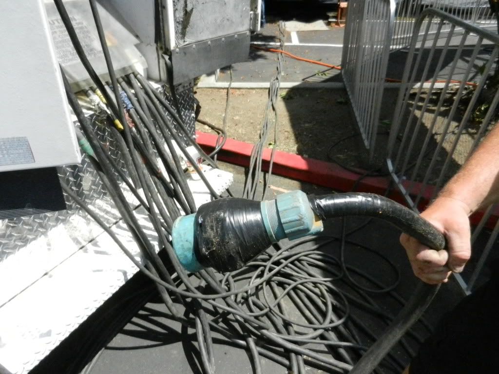

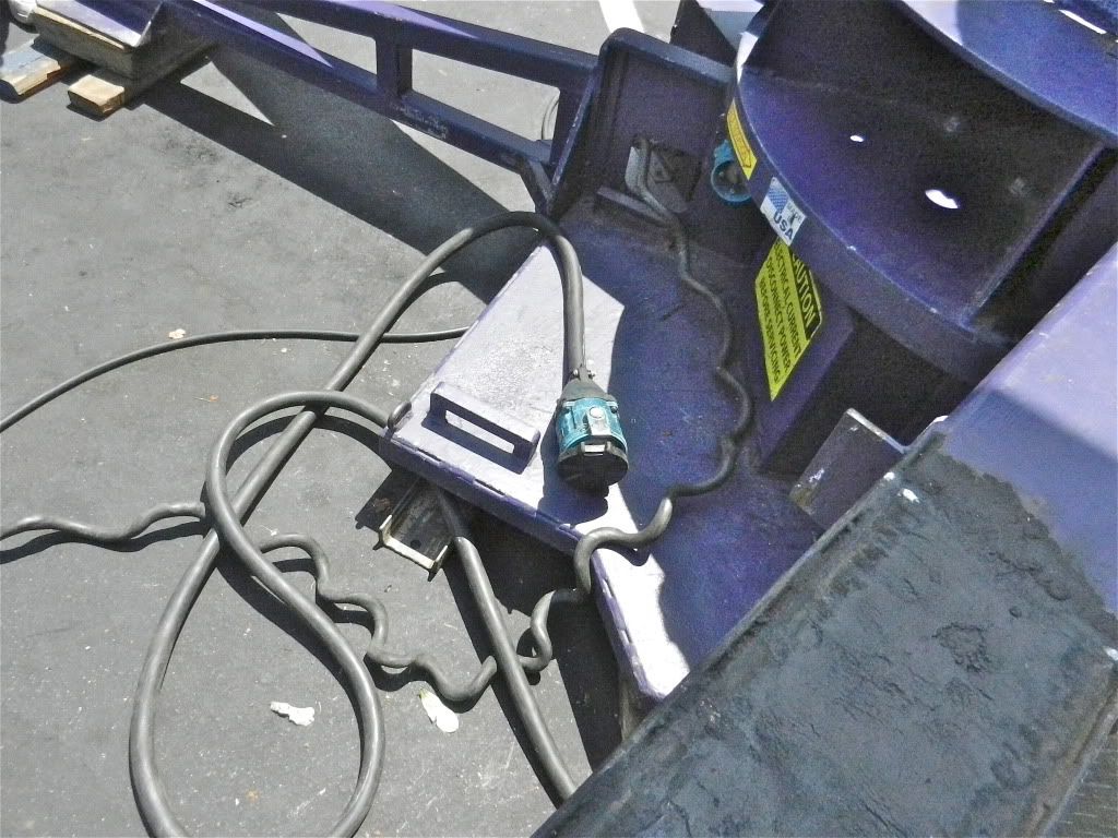

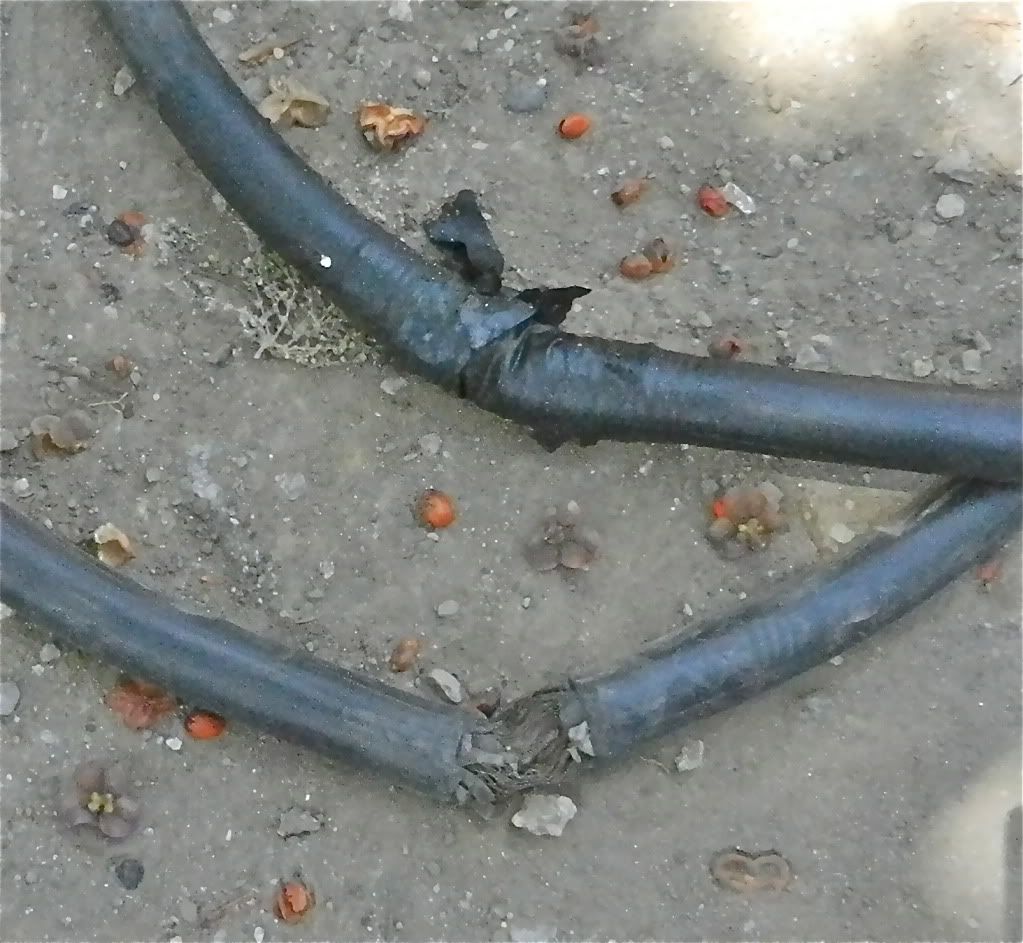

There are a dozen examples of this on this one ride. There are many taped splices.

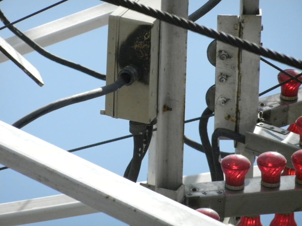

Shirley you will notice the open air conductors located on the back of the panels and powering the lights.
You may wonder why a fitting coming apart is any more dangerous than those open air conductors.
Anywhere that there are open conductors serving lights, the lights and wires are attached to a non-conductive panel. Every bit of the rest of the machine is metal.
The open air conductors were in good condition. The cords and cables suffer damage because the motion of the machine tosses them about and they are damaged during ride assembly and transport. As one of the pictures shows, the cords do get wound up in the machine occasionally.

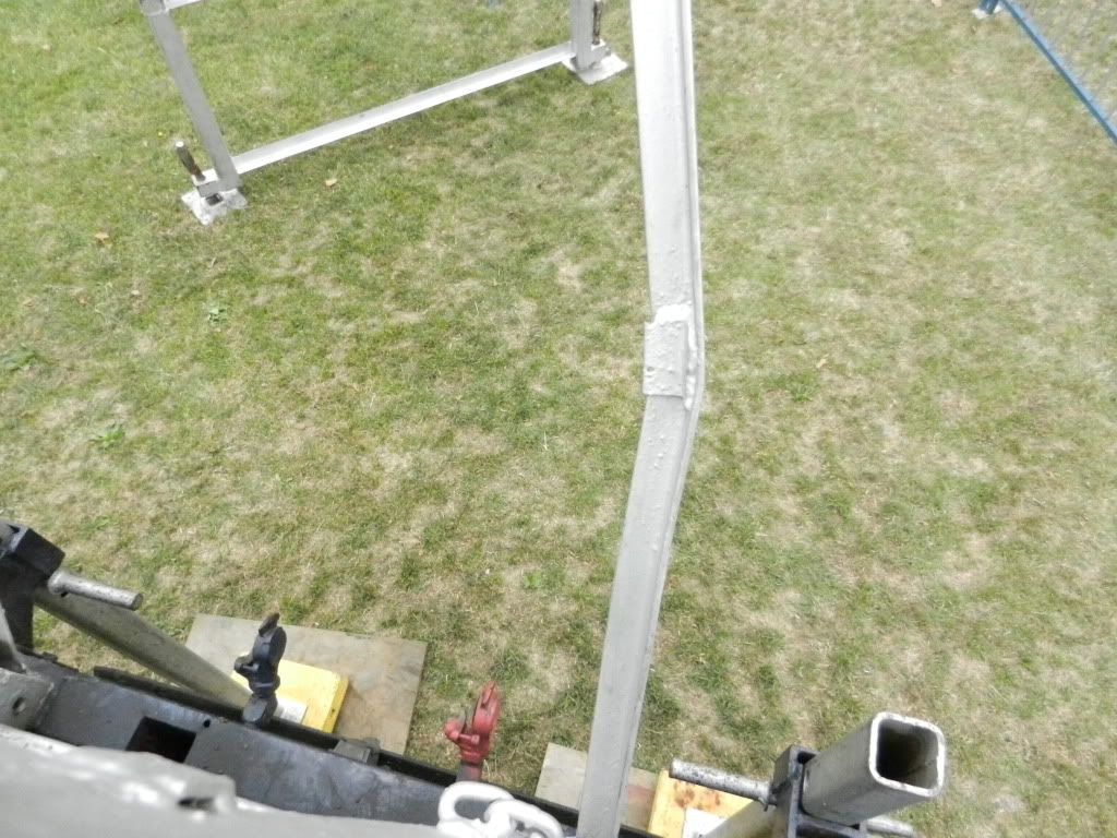

The Dragon Wagon rides these rails like a maglev without the magnet.

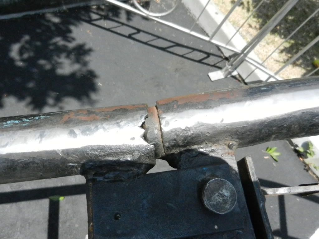

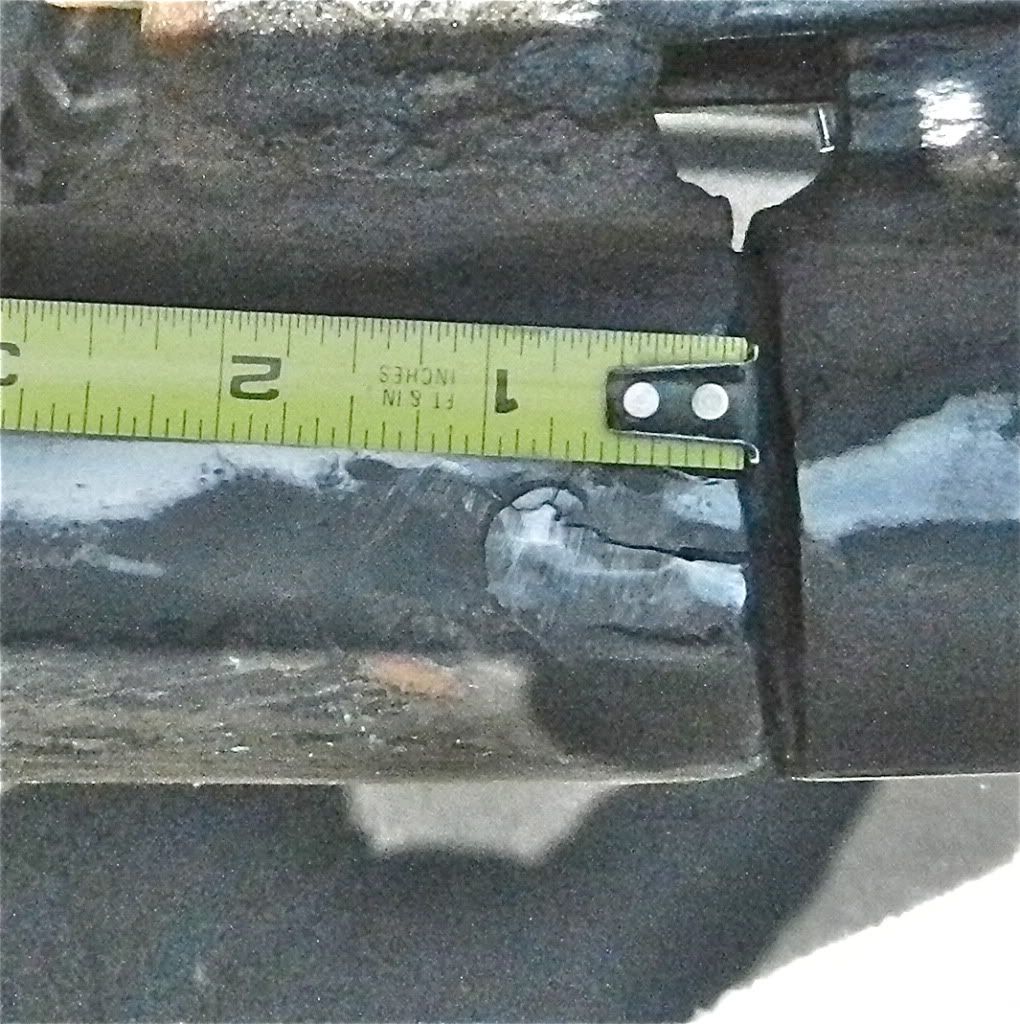

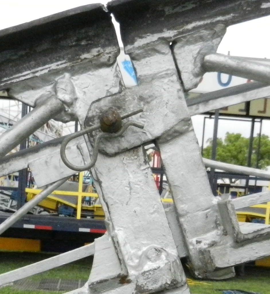

The state says that a "competent welder" is required for welding done on carnival rides. That means that my buddy David can do it because I reckon he's a pretty fair welder.
This example is a failed rail repair that has multiple cracks.
I required a certified welder and they did come back looking like new.
Examples of competent welding per the state.
In years past I have required that welding be done over.
The state is a little too loose with the rules when it comes to placing children at risk.
