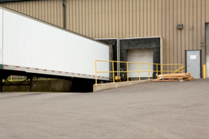

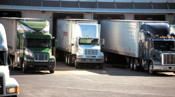

Is the truck dock level with the driving lane or do they back down an incline to make the rear of the truck the same level as the loading dock
This
or this
