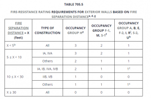

We know that dwelling units sharing a common wall require a minimum 1 hour dwelling unit separation rating, which would not be allowed to have openings.
But what if those units are separated by about 5', and are on the same lot and can be treated as a single building (503.1.2)? Assume type V-B construction. Can the 2 walls 5' apart be nonrated, and have nonrated windows?

I assume the "fire separation distance" in Table 602 refers to either the distance between 2 structures being treated separately, or between a structure and a property line. Neither apply in this case.

That said, the definition of FSD says to measure to very specific items. Lot line, nor CL of a street/alley/public way apply. You may suggest that an imaginary lot line be provided between the two units; however, under 503.1.2, you are treating these as a single building. Meaning there are no "two" buildings on the lot to measure between.
[BF] FIRE SEPARATION DISTANCE. The distance measured from the building face to one of the following:
  1. The closest interior lot line.
  2. To the centerline of a street, an alley or public way.
  3. To an imaginary line between two buildings on the lot.
The distance shall be measured at right angles from the face of the wall.

But take that logic and apply to this: Two S-1 buildings. Each 2,000sf. They are 10-ft apart. Applicant proposes to treat them as a single building. Do you require the imaginary lot line and rated exterior walls where the FSD is 5-ft for each building?
Or think about an existing building where they want to do a small addition. Instead of connecting the existing and new building, they build them a foot apart. Buildings collectively can be treated as one (as if it were an addition), but in reality, they have a gap between them (avoids forces being transmitted b/w them).
How would you treat these two scenarios? All three should be treated the same, right?

Since Fire Separation Distance is measured to an imaginary line between buildings, a 5 ft. FSD would require a 10 ft. distance for windows facing each other. However, if the buildings were only 5 ft. apart you could have windows in one building, but not the other, by placing the imaginary line at the face of the building with no windows.

My opinion is that these structures normally would be built under the IRC and not the IBC and maybe that is why there is a "hole" in the code.....In which case you could go with R302.whatever for FSD >5' 1 hour but at 5' would be zero rating...
It seems like if you have two dwelling units that are in buildings considered to be one building, the two walls with windows facing each other have not satisfied the requirement for a separation between dwelling units. That doesn’t change at 1 inch away or at 5 feet away. It changes when you apply the concept of fire separation distance.
