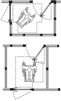

My office works on a lot of commercial restaurants including McDonalds, & Wendy's. We had a discussion about whether a turning radius is required inside of a vestibule. We used to check that the required door clearance was ADA compliant, but then we started discussing whether or not the vestibule needed to be 60 inches wide. Ansi 404.2.5 says that in Two doors in series situation it needs to be 60 inches clear. Does anyone have any thoughts about this?
Also are all vestibules doors in a series? A lot of times in our restaurants the interior door is at a 90 degree angle from the exterior door. Is that still two doors in a series?
It seems reasonable to require a width of a vestibule to accommodate an individual in a wheelchair to turn around. If, upon entering a vestibule and finding the second door locked, or something to that effect, the individual will need to be able to turn around and exit the vestibule. The alternate layout (90 degree), would also be doors in series. The graphic below is from the 2017 ICC A117.1.
Thanks. The top image is what we get 90% of the time in the restaurants that we work in. The other 10% is probably the bottom image. We used to look mostly at the ADA requirements which unless I'm mistaken, does not say that the vestibule has to have the 60" clearance. We used to just look at the required door clearance, in our case usually a 54"x60" clearance. This is more of an Ansi standard I guess as opposed to part of the ADA law.
The diagram you show with both doors swinging into the space between the doors is not allowed per IBC 2018 1010.1.8, 1010.1.8 says the doors have to swing in the same direction or away from the space.

It’s disappointing that A117.1 Figure 404.2.5 uses the same diagram shown in Post #1, I would have hoped that ICC would have better coordinated the IBC with their referenced accessibility standard.

Where did you get that ADA image? I have a copy of the 2010 ADA and the diagram doesn’t say anything about existing facilities.

That's from 2017 ICC A117.1 section 404.2.5. I was told that you should always go with the more stringent option. I have also been told that a permit reviewer doesn't look at ADA. They look at either what IBC says or Ansi which is sometimes referred to by the code.

What section is this image from? I don't see this in section 404
ICC/ANSI A117.1 is a reference standard of the IBC and it always applies, unless the adopting jurisdiction expressly edits it out when they adopt the IBC.
Thank you. The image I showed is from the 2019 version, it’s on my to-do list to get the new version.

If you're going by the ADA, California Code, or any other jurisdiction that uses the 2010 ADAS as a standard, then a turning space not required in this situation. While it's definitely a nice thing to include, it's not mentioned in the scoping or technical requirements as far as I see.
If you're going by ICC A117.1, then it seems the turning space is required.

The 2017 ANSI 117.1 increased the turning space for new buildings from 60" to 67". In 404.2.5 for doors in series they require "a turning space". They do not use language found in many other places such as "a turning space in accordance with 304". They then provide multiple illustrations showing a 60" turning space for new buildings. Just going by the language are we to presume the "a turning space" is as required by 304? Or since they provide the illustrations that show a 60" turning space that the turning space is permitted to be 60"?

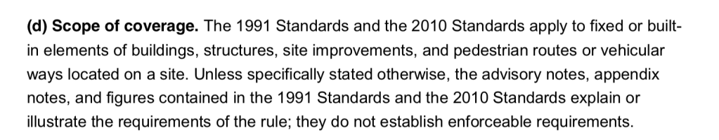

So really two issues: 1)what prevails when a conflict is found between language and illustration? and 2) Is there a conflict if the language does not include any metric for the requirement (a turning space without any metric could mean anything)?
For the 50+ years I've been licensed as an architect, it has always been taught that the written text prevails in case of a conflict with an illustration.
I would agree, but in this case the written text does not provide a metric. For example anywhere the ANSI standard specifies operable parts for an element it does so by saying the operable parts shall comply with section 309. In some places it will require compliance with an accessible route, yet in others it requires an accessible route complying with 402. In the case of doors in series it just says to provide a turning space. I am going to assume it really wants to say complying with 304, but didn't. I'll let them argue their case.
