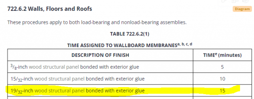

Meanwhile, I will propose that the inspector read the document produced after 23/32" thick plywood was tested in accordance with the test method for evaluation as a 15 minute thermal barrier. And that test was conducted by an approved independent fire test laboratory. If one layer is good, then two layers is better. The test was conducted eleven years ago but I don't think the laws of physics have changed since then.

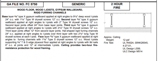

FYI, there is no UL(C) assembly for a two-hour fire rated floor that involves standard wood joists. Of the top of my head. I think the only combustible assembly that has a two-hour rating are three layers of 5/8 type *C* on resilient channels, with Roxul in the joist cavities.

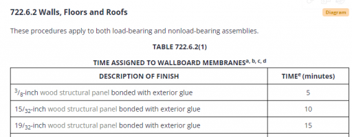

As usual....The electrical inspector knows nothing about building stuff so they should stay in their own lane.....If 19/32 works, Shirley 23/32 does...
Looks like you missed footnote e:
"e. The time assigned is not a finished rating."
So not useful for the OP, unfortunately.
Cheers, Wayne

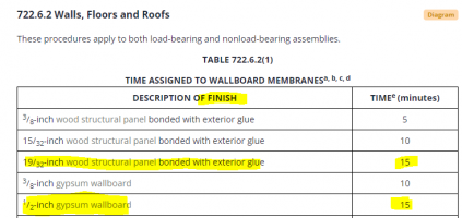

Unfortunately there is no good commentary on that footnote.....I can only ASSUME that it is saying that it is implying that a sheet of plywood or gyp has no rating unless it is installed as a part of a "finished" assembly why else would the table have "finish" in it......As we are talking about thermal barriers but not necessarily fire ratings, that involves heat transfer on the other side of the barrier, which is part of determining the fire resistance rating of an assembly:
Fire-resistance rating takes into account the rise in temperature on the unexposed side of the membrane.
This must be like when mu electricians try to explain stuff to me....Sorry Tim!
After the State Fire Marshal agreed with me that the 3/4" plywood has the 15 minute value - that the electrical inspector is looking for - the electrician still insists on the 1/2" gyp.bd. Another electrical inspector recommended that I file a formal appeal to the State Electrical Board because the electrician is not seeing the difference between a 15 minute thermal barrier (test standard = NFPA 275) and a 15 minute burn time (test standard = NFPA 221 and ASTM E119). And that experienced/older electrical inspector went so far as to say that while trying another/younger electrical inspector, there was confusion while trying to explain the difference between "thermal barrier" and "burn time". So the older electrical instructor dumbed it down for the new/younger inspector by saying "Sure. Let's go with simple burn time instead".

Go to the IEBC, at the back of the book. Resource A-117. The first part of Resource A describes how to use the various tables to calculate the fire-resistance rating.
Look at assembly F/C-W-8 and F/C-W-9.
