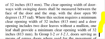

From IBC 1010.1.1, at least one leaf needs to provide 32" clear (which we do with the 36" door):
