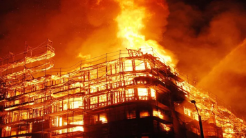

Los Angeles
Fire Destroys Apartment Building Under Construction
Los Angeles
From the article:
Officials say that they are inclined to believe the fire was intentionally set.
Typically, codes and requirements have shied away from trying to regulate safety in relation to deliberate acts of arson and associated deliberate property damage. Wood buildings are no more or less susceptible to deliberate acts of sabotage than any others.
There is no more risk in a utopian society where all remodeling and maintenance afterwards is code compliant and does not compromise fire rated assemblies.
I really think we should try and focus on regulations to ensure people are properly incentivized to follow the proper procedures for permitting and inspections. Not outlawing construction just because some people are negligent.
