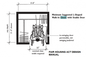

I had a third party reviewer comment on the depth of my walk-in closets in a couple of Type B units recently...that they were over 48" deep and didn't provide a turning space. Granted he also referenced the Type A section of A117.1, so I'm fairly sure he's wrong, but it got me thinking:
  • Is there any requirement for turning space at Type B closets? I thought these were exempt...
  • I remember reading/hearing something a long time ago that shelving depth (if fixed) was removed from the depth of the closet, which in this case would make them less than 48" deep anyway. I can't seem to find anything on this, however, so it's probably wrong or a bad memory...

So now that the diagram has been posted, I don’t see the problem. You said your depth is 48” and the diagram shows 5’x an6 width, and doesn’t call for turnaround. So you’re good ... right?
Not really...FHADM has no real authority other than for funding purposes. IBC and ANSI A117.1 are the applicable codes that would be enforced, not to mention that the FHA diagram is only really talking about the door width on deep closets being able to allow entrance. FHADM doesn't say that that's an accessible closet anyway, just that it's acceptable for fair housing. I suppose you could argue that that's the same thing as Type B in this case, but again it's not an enforceable standard.
That said, DMartin's diagrams and reference clear up the second question for me and I'll just assume that since no one can point to any standard for Type B depth that there isn't one.

The 2010 Standards of Accessible Design Section 305.3 describes the clear floor area for rooms, including storage rooms, as being a minimum of 30″x48″. This is the amount of space required by a wheelchair. In storage closets it is important to have not only the minimum requirements, but if they are full entry closets, then the ability to turn around and exit the closet will also be required. Many times, storage closets are designed narrow and deep, which becomes problematic if the person in the wheelchair is able to fully enter the space and not get back out.
Shallow vs. Full entry closets
There are two types of closets: one is a “shallow closet” space which is shallower than the 48″ x 30″ required by a wheelchair and therefore does not allow full entry. A closet that is deeper than 48″ would allow full entry by a person in a wheelchair.
In storage facilities (i.e. closets) that allow full entry, a 5′-0″ turning space is required so that once in they can turn around and get out without risk of getting stuck. What if you don’t have the five feet? Then you can make the deep closet act like shallow closets. Here are some examples:
If you have a wide closet that is 48″ wide and 48″ deep, but no 5′-0″ space, try adding shelving to the back to make the space less than 48″ and therefore does not allow for full entry.
Deep Closet and no turning space
I would say that shelving can be used to make it shallower making no requirement for turn around
