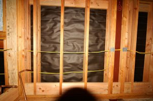

Have you ever seen Tyvek used on the inside of exterior walls?
I am very surprised to see a change here from the last code I looked it up under, in the past there was also an exception allowing for an approved alternative, in the past CBO's who allowed Tyvek did it under the approved alternative exception and as far as I have ever seen required documentation in the form of an ICBO or ICC Report. In the 2013 Code I see no exception allowing Tyvek or any other plastic wrap at all. In the past allowing it was misfeasance, allowing it now is malfeasance.\ said:R703.2 Water-resistive barrier. One layer of No. 15 asphaltfelt, free from holes and breaks, complying with ASTM D

You know I considered that on a house but the mills, at least here in California, don't mill it any more, my yard offered to run 2x8s through their resaw machine to make them for me. Too bad, we actually wanted very low quality material so plenty of air could flow through it. Back in the 40s and 50s the first thing I did when starting a house was ordering units of 16' 2x4s and 16' 1x8s, we used the 2x4s for walers and the 1x8s to line the forms, after we stripped we had a laborer clean them up so we could reuse the 2x4s in the framing and the 1x8s as diagonal subfloor and wall sheathing if we were building a stucco house, we never sheathed a house getting redwood siding so the redwood could breathe, by the mid 50s we eliminated wall sheathing altogether and used line-wire behind stucco so it could breatheDiagonal board sheathing is a prescriptive bracing method as well.
I have seen Tyvek end up in a pile on the top of the bottom plate. There is another product called Barricade that is much more durable. I don't know if it rots like Tyvek.Have you ever seen Tyvek used on the inside of exterior walls?

How do you know as a plan checker which "style" complies?View attachment 2409
They have to use the correct style but the report says they comply with type D paper.
Cali. might require more but here just the min. above and beyond is great but don't get it much.
