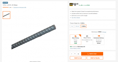

So, a house with plastic plumbing, on a slab with no rebar, non-metallic wiring methods, wood framed... Do you make them throw in an $8 piece of rebar for a Ufer or just drive two ground rods?
If they work includes a new footing…then yes a CEE is required. The CEE can be steel or copper.
If they work includes a new footing…then yes a CCE is required. The CCE can be steel or copper.
While that sound like a good idea, it's not required by the NEC. The NEC tells you what configurations constitute a CEE (250.52(A)(3)) and that if that configuration is present, you must use it for a grounding electrode (250.50), but it doesn't require you to create that configuration.

No argument here. It has always been the position that if a new service and a new footing are being installed then a ufer is required. It has always been part of the job card checklist. Now if there is just a bunch of tiny pieces of steel that can't create a 20' length ... well the copper alternate would be required. So your contention that a ufer is not required until it is installed makes perfect sense. It just won't fly here. I suppose the reason is the relative efficacy compared to the other electrodes.
So I stand corrected. A ufer is up to you and your particular situation.
