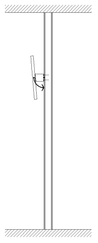

The load imposed by something like a flat screen television hung off a wall is an eccentric load. In other words, the center of mass of the television isn't located directly above the centerline of the studs. This means that, although gravity acts vertically in the television, the load isn't transferred vertically to the wall. Of course, it isn't transferred horizontally, either. In fact, it's a rotational force.
The screws want to pull out of the wall, imparting a torsional load on the studs. But it's a relatively small, concentrated load. How much does a typical flat screen television weigh? 50 pounds? 100 pounds? If we assume a wall 8 feet high with studs at 16 inches on center, each stud has a tributory area of 8' x 1.33' = 10.64 square feet.
10.64 s.f. x 5 psf = 53.2 pounds. And wall studs are repetitive elements, so we can assume that some load is shared with the studs on each side. In fact, for something like a flat screen television. there's probably blocking in the wall to distribute the load over at least three studs.
I don't see a problem.

The attached image is a sample page from one major European manufacturer's installation booklet, where they provide simple tables with the cantilever loads permissible for each system, using approved screws and fasteners/
Similar documents are available by all manufacturers.
The thing is that local distributors hesitate to give a clear answer on whether hanging such loads on a rated partition voids the fire rating certification.
Since my current projects are US based hotel companies and American Codes are applicable, i am investigating the exact US Code or Standard reference stating that a UL263 certified system maintains its fire rating if we hang cantilever loads within the structural limits.
Which exactly are the "limiting conditions of design as determined by nationally recognized structural design criteria" mentioned in the UL263 test?

UL263 requires the test specimen to be loaded to it's max allowed by the building code. If it is loaded less than that it will be noted in the listing with a % of maximum load restriction. When the walls are designed by an engineer, they will be loaded less than what was used in the test (assuming the wall is listed as load bearing). If there is a restriction, the engineers must design it to less than the listing, e.g. 80% restriction, they would need to design a wall in which the design load does not exceed 80% of the capacity. TVs and other similar items attached to the wall are negligible.
100plf in the definition of a load bearing wall in the IBC has no relation to the UL263 test loading.
UL263 requires the test specimen to be loaded to it's max allowed by the building code. (...) TVs and other similar items attached to the wall are negligible.

If it says "Bearing Wall" on the listing, the engineers can design it to its full design capacity. By bearing they mean structural loads, not TVs.
Again, the 100plf in NOTHING to do with the UL263 test. 100plf is definitely NOT a maximum. The maximum amount allowed by code is determined by the required calculations in the code which are done by your engineers.
You're overthinking this. No plan reviewer or inspector in my 30 years of doing this has ever mentioned the load of a TV or casework on a bearing wall, rated or not.
