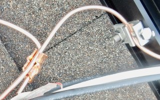

1. Listed pressure connectors
As luck would have it, I have pictures.
They come in sizes for a reason.
The number and size wire is predetermined by the manufacturer. It is never more than two.
A proprietary tool is required to close the crimp. Pliers are not allowed.
The last picture shows the indent marks that are found if the correct tool was used to close the crimp however there is still an issue with the size.
They thought it through almost to the end.
This guy was not going to give up.

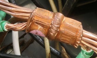

An inch short might as well be a mile.
Here's that lack of respect showing up again. That they would leave this for me to find says volumes about their work.
