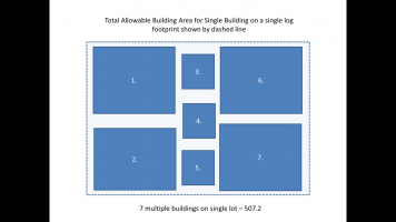

I'm getting caught up on some language in the 2012 IBC. In Section 503.1.2 it states that two buildings may be regulated as one building if the building area is within the limitations of 503 as modified by 504 and 506. It does not, however, mention the "modifications" of 507.
507.2 allows an one-story S-2 building with at least 60' clear yard to be unlimited area.
I am curious of others' interpretation of this and whether it would be allowed to consider two unlimited area S-2 buildings as the same building.
I have attached a sketch of the scenario in question.
I must take the opposing viewpoint here...
503 specifically recognizes the modifications in 504 and 506.
If the intent were to allow multiple unlimited area buildings to count as one then 503 would also cross reference 507.
Since it does not one would be limited to using 507 for a single building only.
As a practical matter it forces the described situation to use a construction classification that already allows 'unlimited area'. With some exceptions, type IA and type IB generally allow UL for area in table 506.2.
No, not without the open space requirement between the two buildings

The commentary in 507.1 states "Two unlimited area buildings on the same lot must be separated by 60 feet unless they are treated as a single building under the provisions of Section 503.1.2"
I disagree with the commentary. The code does not reference Section 507 when applying 503.1.2.
503.1.2 Buildings on same lot.
Two or more buildings on the same lot shall be regulated as separate buildings or shall be considered as portions of one building if the building height of each building and the aggregate building area of the buildings are within the limitations of Table 503 as modified by Sections 504 and 506. The provisions of this code applicable to the aggregate building shall be applicable to each building.

Along these same lines of confusion, if I had four small detached buildings on the same lot built using same type of construction (VB), the same occupancy (M) and the same size, can the required separation between buildings be 4'-0" as compared to Table 602? Do I need fire rated exterior walls at separation locations as noted in Table 602 ? Are windows not permitted on these walls as noted in Table 705?

The last sentence in 503.1.3, Buildings on Same Lot, is the basis for the above question. It states "The provisions of this code applicable to the aggregate building shall be applicable to each building." Four separate buildings or one aggregate building?
The use of allowing multiple buildings as one building is the same as building one building with four tenant spaces - however, this provisions creates headaches when modifications or changes of use involve one of the buildings on the lot.
I then have to review the plans as if the space was located in one building, so fire separations, fire sprinklers, fire alarm and so forth may become required.
Imaginary lot lines would not apply if the separate buildings are considered to be one building as allowed by 507.2 (503.1.2 - 2015 IBC). The exterior fire rating by T602 . 705, etc. would apply only to the walls along the exterior footprint as if it was one building. No fire separations, fire alarms, fire sprinklers or any fire ratings are required unless the aggregate of the occupants, total fire area, etc. exceeded the requirements or the thresholds as established by code in other sections. However; alterations to building 4 may have an impact on the remaining buildings is the thresholds are exceeded.
This is the trade off allowed by this section. Each building is not a standalone building and would basically be looked upon as a tenant upfit for the "single Larger" Building. Thresholds for fire protection features would still be the same as if all 7 buildings in this example were in one building.
