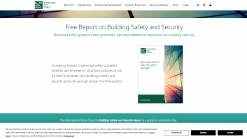

You may find an answer in this free publication
