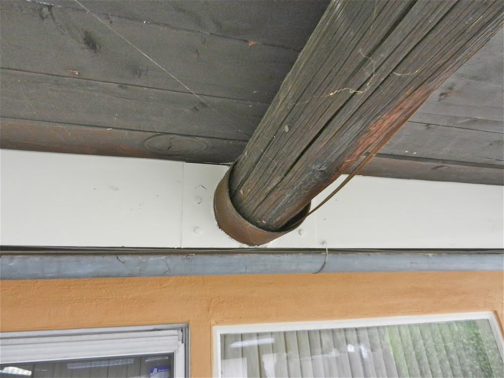

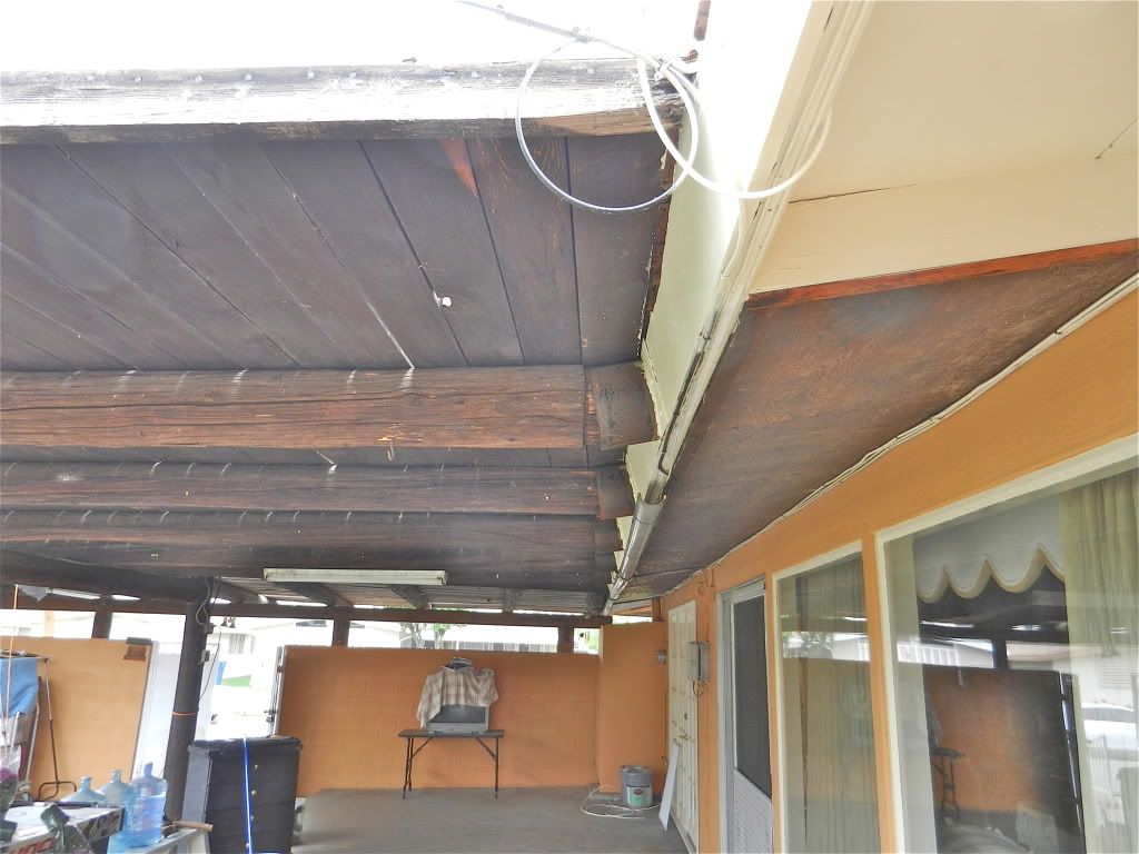

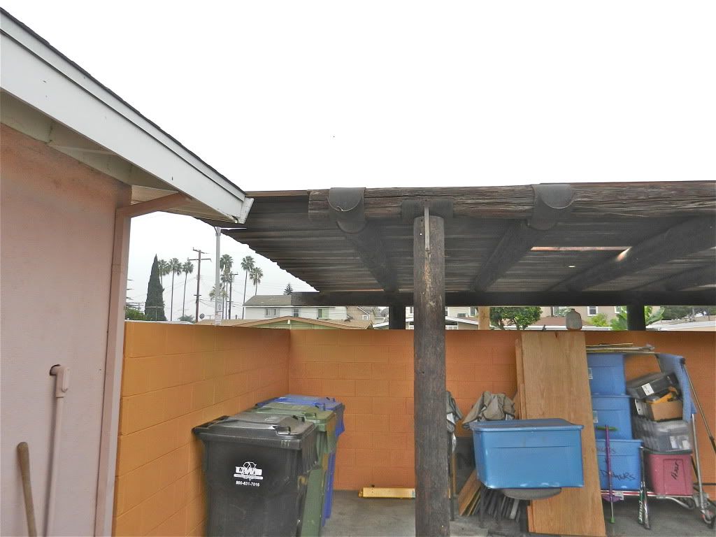

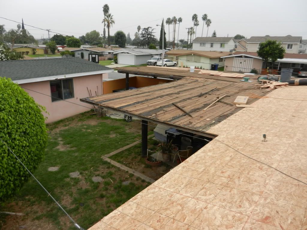

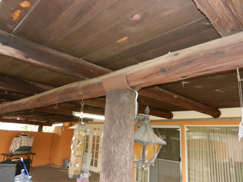

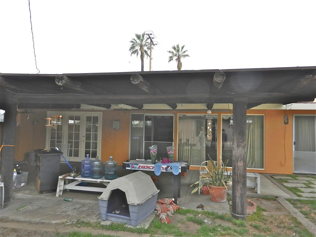

There is a permit from 1983 to "legalize" the patio cover. That means that it was built without a permit prior to 1983. The permit doesn't indicate square footage and this is about 1000 sq. ft. Beyond that fact that it is dilapidated is that it was never structurally sound, or even close. Many of the saddles have no attachment to the beam. Some have one nail. The only counterforce to uplift is gravity. The owner wants to replace the roofing.
The hardware is a sleeve that fits the round beam with a saddle welded to the sleeve. That sounds reasonable enough until you realize that the sleeve is free to rotate.

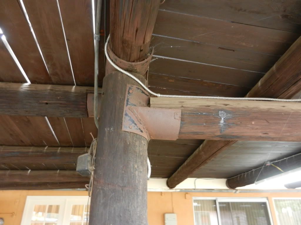

There is a beam splice over the post and the beams are free floating from the post and each other.
The beam is held in place by magic. There are six just like it. This is proof that a fascia board can be stronger than we give credit. The same goes for air connections.

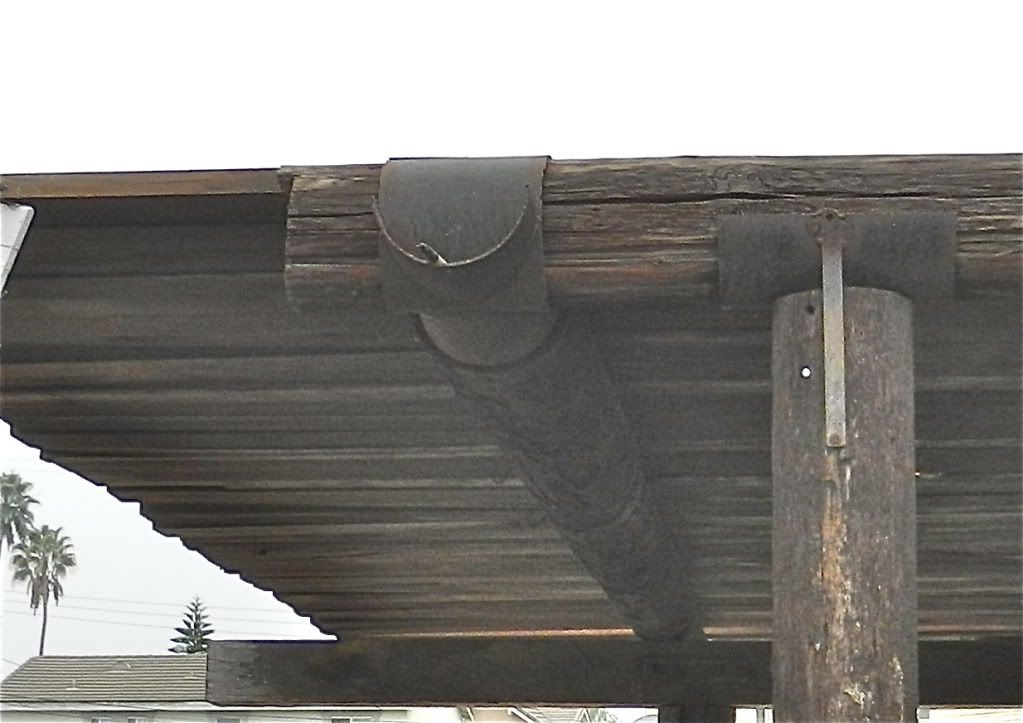

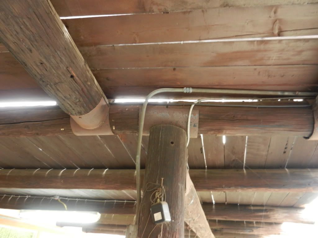

The saddle is attached to the post with one nail on one side of the post and the beam is not attached to anything. The 2"x6" sheathing is cantilevered and a bit rotten.

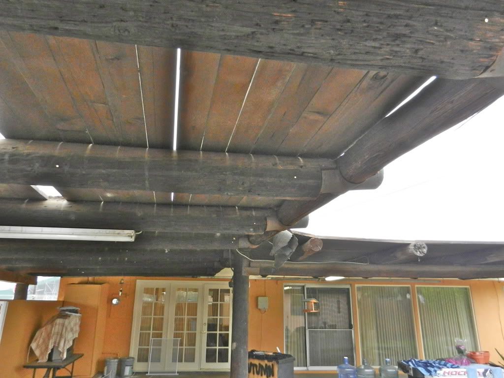

In as much as there are no positive connections anywhere else, I would guess that the beams resting on beams are doing just that, resting. The sheathing is holding them in place. Taking this mess apart will require a plan of action. The job will most likely fall to a crew of landscapers.
hmmm..... wow....... again. The fact that this made it long enough to need the roofing replaced, and rot the decking is amazing. They must get zero winds. Make it legal by tearing it down, as you said, systematically and carefully. eeeek
Sure would like to see whats behind that soffit. Just to see whats held it up this long. My vote Demo Demo Demo.

They are firewood. It's gone.
