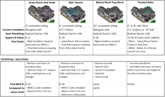

Greetings,
I have a 3.5-year-old home that is generally great, but we have ongoing issues with roof condensation and mold forming under the eaves and down the siding. I suspect this is partly because our GC’s insulation subcontractor—his “expert”—believes our town does not need to follow R806.5. I find that hard to believe. I still checked our city’s residential code amendments, but I couldn’t find anything on the topic.
From what I can tell, the easiest way to get to a code-compliant solution would involve removing the solar panels, tearing off the existing roof (including OSB), taking out some of the old insulation, and then rebuilding with a rigid insulation layer on top. We would also need to spray PU foam below the roof deck and then patch that back up. I plan to have an independent inspector review everything this time around.
I’m looking for feedback on code compliance to better understand whether our GC or his subcontractors might have some responsibility for the repair costs.
Seal Beach, CA. New construction, Finished in 2021, California Energy Code Zone 6 or IRC Climate Zone 3B
2016 CBC, 2016 CRC, 2016 CEC, 2016 CPC, 2016 CMC, 2016 CA ENERGY CODE, 2016 CALGREEN, SEAL BEACH MUNICIPAL CODE, RLD-9

Radiant barrier adhered to OSB sheathing requires a minimum one inch air gap.
Air movement is critical. If the temperature differential can allow condensation, the only remedy is drying, which is usually a function of air movement. Any enclosed rafter assembly or non-vented attic makes me nervous. It is very hard to maintain balance between outside temperature and inside, and by extension the condensation that can occur. Roofing manufacturers are discovering that a lot of air movement in attics used to come from air leakage from the house, and the tightness of buildings has cut that way down. There have been a lot the types of problems you are calling out cropping up. There have also been a lot of condensation issues with spray foam. IMHO spray foam must be installed PERFECTLY in order to work properly. How often is the word PERFECTLY used in construction?
Speaking with a roofing expert and association rep, he advised that ventilation (lack of) is a huge issue they seeing right now.
Do you know if the mold is only on the siding and eaves, visible from outside, or is there evidence of it within the building?
The fix of removing roof and building up solid foam is interesting. I've not seen it often in residential but, in fact, exactly what I planning (though not sure I'll build it.) But I will have no insulation under roof sheathing, and 10" - R50 - in foam - with just purlins and metal roof on top.
I don't know if you can be assured of no condensation in the fibreglass or underside of roof deck. It would depend on "perfection" in most parts. And I prefer very tolerant and easily maintained and renewed building systems.
Were the construction plans prepared by the general contractor, or by someone else?
Anecdote: Last year I had a project that tore off the flat roof sheathing on a motel in Huntington Beach about 3 miles inland from the Bolsa Chica tidal inlet (somewhat close to Seal Beach), first built in the1980s. The roof had R-30 batt insulation between 2x joists. It is not a perfect installation. The roof assembly was unventilated.
We found some water damage to the sheathing due to the built-up asphalt roof membrane leaks, but there was no evidence of condensation, or related mold or mildew damage where one might potentially anticipate a "dew point" within the assembly. Perhaps the whole building is so "leaky" that the assembly did not trap condensation, or perhaps the climate is so mild that condensation had not been an issue.

ICE – regarding the radiant barrier on the OSB: thanks, we plan to replace that layer in the unvented areas and that’s consistent with what our plans asked for.
Sifu – regarding the spray foam. I’m hoping to avoid this option for everywhere except roof-top-deck. Otherwise, I think we would need to tear into it from the top.
Bill1952 – we have some mold on the inside of the house along the exterior walls, both downstairs and upstairs. However, since we’ve already done roof-leak repair in specific spots, and the bottom of the siding has been trapping water around the home’s perimeter, so it’s hard to tell if the interior mold is due to roof insulation / ventilation issues or combinations of other things. For example, we had this growing into the room below the roof-top-deck:
Yikes – The plans weren’t made by or GC, and they didn’t clearly specify the roof insulation layout. The plans state on page 1 that the home must meet Title 24 requirements regardless of what is shown elsewhere.
Unless there’s an easier way, we plan to pull off the roof and osb over the unvented areas, so we can replace water damaged insulation if we need to.

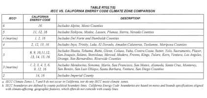

Mark – thanks for clearing up the climate zones because it has been driving me crazy! I think my confusion is coming from some CRC R806.5 tables use IRC zone definition (8 total zones, where I’m 3B) and others the CEC definition (16 total zones, and I’m 6). Either way, I think I’m in the R-5 category for rigid-above-the-fluffy for section 5.1.2.

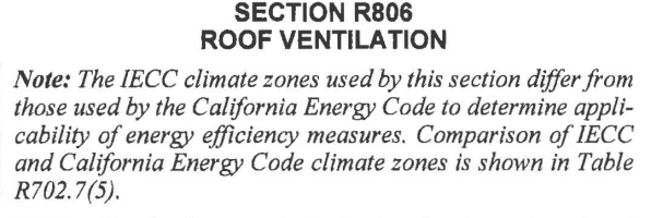

This is a good reminder that CA (like some other states) makes statewide amendments to the model code. Also in this state, the latest edition of code is a mandatory minimum across the state. Local jurisdictions can make more restrictive amendments but cannot go less restrictive. As compared to some other places where a jurisdiction can choose to stay on the 2008 electric code indefinitely for example.
Thinking about the climate zone issue, and reminding myself that CA has its own system, I wanted to verify my own climate zone. The CA Energy Commission has this "zone by zip code" spreadsheet, and I thought I would share it here:
File format is not supported by the forum, so I posted a link to the page where I downloaded it.
Yeah, I see what you're saying now, I never really looked deeper into this because I'm in climate zone 1. It is definitely a conflict and I'm not sure I have the answer yet, but here's a little more on the topic:
It looks to me like you have to use this table to determine your climate zone for the purposes of 806. For example, I've always "known" that I am in climate zone 1. But if I'm analyzing 806, I need to consider myself zone 4. That appears not to be an issue as everything still works and I have not been giving people the wrong information. It appears though in your case it does make a difference, and I would say that you should be using zone 3 for this section.
Thanks, this zone stuff had me going in circles.

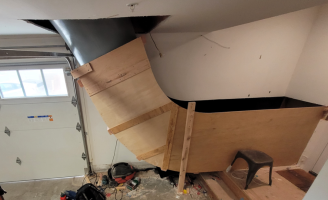

That's where the slide transitions from a round to rectangular cross section. The part on the right is a workbench now.
The last drop is pretty steep, around 55-deg down. I had it at 65-deg originally, but that was really dangerous.
Here's what it looks like from inside the slide and from the hallway.
