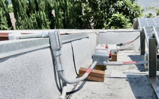

They put a bunch of holes in this shot roof. Note the lack of wire management.
This looks like they remembered that there's equipment at the last moment. That's an access aisle for the fire dept.... on the plans anyway.
