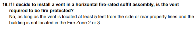

Picture a type V-A apartment building with private balconies stacked over each other. You've used a membrane assembly (say, type X purple gyp board with stucco) on the underside of the balconies to achieve the 1-hour rated on the balcony wood-framed balcony floor.
Question: how to you both vent the balcony framing space as required by 2304.12.2.6 and maintain the continuity of a one hour floor-ceiling assembly?

Balconies must carry loads as required for floors, but a balcony is not necessarily required to be a horizontal assembly that requires the same protection as the floor inside the building.
Refer to Section 705.2.3.1 (2018 IBC) for requirements applicable to balconies. If the framing is of fire-retardant-treated wood or heavy timber, then no other protection is required. If sprinklers provide protection at the balconies for Type III, IV, and V, then, per Exception 3, the construction can be of Type V construction with no fire-resistance rating required.

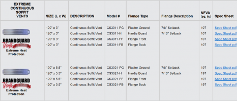

Mark: thanks, and I an aware of the continuous vent products, and have used them on projects. I just wondered if, in the process of venting, I was causing a problem with the fire rating.
RLGA: In other words, on a type V-A building a balcony must have either FRT or a sprinkler head below it?
No, you can use standard wood framing, but then you would need to comply with Table 601 for floor construction. FRTW, heavy timber, and sprinklers are just alternatives.
