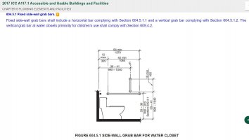

Hi everyone! I just registered on this awesome forum and hoping to learn from all of you. Here is my first question:
What kind, if any, feedback are people getting on the requirement of vertical grab bars? My understanding was that the requirement for these (at least per the ADA) went away with the newest code version however I've gotten feedback from GCs several times in recent projects stating otherwise. Has anyone else been experiencing this? Looking into this further I'm thinking it may be a difference between ADA and ICC. While similar, they are different and building codes usually reference the ICC which appears to still require a vertical grab bar.
Accessibility is not my best subject, but I think the vertical grab bar by the water closet is originally from the ANSI standard, which I believe the ICC version is based on.
We only enforce ADA here, and amend ICC version out of the code.
Julia, you are fairly correct in your speculation. Most states (exceptions being CA, KS, and a couple others), follow the ICC A117.1 Standard, which requires the vertical grab bars. Some states have decided to follow the federal (DOJ administered) ADA.
In looking at CO, it appears that the Office of the State Architect, via Approved State Building Codes Exh-A-Bldg Codes, follows the current edition of ICC A117.1, Accessible and Usable Buildings and Facilities as referenced in the adopted edition of the International Building Code.
So vertical grab bars should be installed in your projects.
The IBC references ANSI A117.1. At one time the technical sections were identical to the 2010 ADA Standards for Accessible Design. A couple code cycles ago ANSI added the vertical grab bars and increased the turning circle diameter. Check which version of ANSI your state uses.

OIP.LxqtS1f2wnNBK2YkEtIC1AHaJ4
