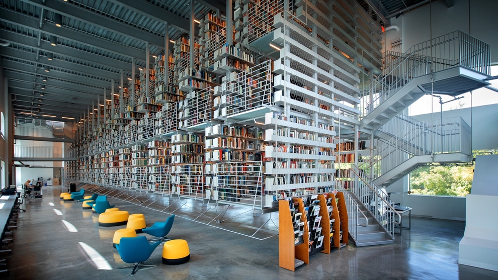

Reading the 2015 IBC Code Commentary, I'm getting mixed signals. On the one hand, the Commentary seems to suggest that spaces adjacent to the atrium can be considered part of the atrium, even if they do not meet other requirements in Section 712, as long as they meet the atrium provisions (basically for smoke control). But on the other hand, the smoke control rationale for atriums seems to be violated by suggesting that these three open stories—with permeable floor-ceiling assemblies that do not meet the other provisions of Section 712—are part of the atrium. Here's the relevant Commentary passage: "Exception 3 recognizes the desire to have at least some floors open to the atrium, and permits a maximum of three. ... The exception also states that the smoke control design must account for these spaces. This particular reference to the smoke control design does not require that the 6-foot-high (1829 mm) layer required by Section 909.8.1 be maintained in these spaces. Instead it is saying that if a smoke control system is required by Section 404.5, such spaces must be accounted for in terms of the hazard they pose to the atrium and to smoke migrating to other adjacent spaces or other stories open to the atrium. Essentially these spaces have simply increased the possible design fires that may send smoke into the atrium, thus threatening to send smoke throughout the building and other adjoining spaces."
In other words, the Commentary seems to envision adjacent spaces outside the atrium boundary that can be considered part of the atrium from the standpoint of smoke control. Such spaces do not intrinsically threaten adjacent spaces since any smoke originating from those spaces is directed into the atrium's smoke control system, where it stays in the vertical opening of the atrium. But in the condition I'm concerned about, with the three stories actually within the boundary of the atrium, smoke originating in one of the lower library stack stories would not be directed into the atrium's vertical opening, but would rise directly through the open floor-ceiling assemblies into the other adjacent library spaces.
I believe that this particular scenario was not envisioned when the atrium Code rules (or the Commentary) were written.

Nice photo of the Salt Lake City Library: From what I can see, it is configured as a classic atrium, with three "open" stories and the rest enclosed. But my question was not about the idea of an atrium in a library per se, but about whether the three open stack levels adjacent to the atrium could themselves be constructed of open steel grating, seemingly violating the requirements for vertical openings in Section 712. In any case, the building is real, the perspective was an early schematic rendering, and the actual atrium, as built, is shown below.
