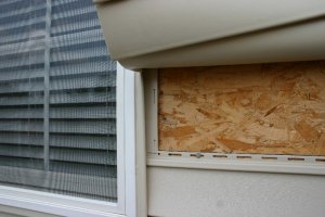

So after the framing inspection you decided to button up and did not think we would check this did you?
This is an old photo so it was addressed already. What would you do?
Fail it..do overs......
R703.1.1 Water resistance. The exterior wall envelope
shall be designed and constructed in a manner that prevents
the accumulation of water within the wall assembly by providing
a water-resistant barrier behind the exterior veneer
as required by Section R703.2 and a means of draining to
the exterior water that enters the assembly. Protection
against condensation in the exterior wall assembly shall be
provided in accordance with Section R702.7 of this code.
