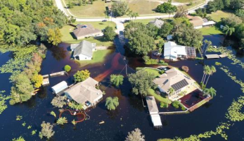

This is the first pic that came up on my screen when I search Deltona.....
Is the house on the left side that house lol?
And why is the water red?
I also note that Lake Mary is close by to that. Are you do insurance work there steveray.....
