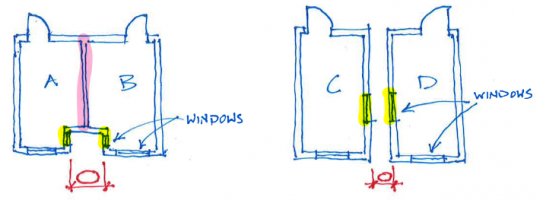

Wall / opening ratings between adjacent dwellings?
Yikes
Nov 2, 2009
4,104
Southern California
See image below:
Assume all structures are type V-B, and are collectively small enough to be treated as a single building on the same lot (503.1.2).
What are the rating requirements for walls and openings:
  • Scenario 1: Dwelling Units A and B have a one hour fire partition between them (pink highlight) for dwelling unit separation per 420.2. The exterior wall modulates to create an alcove, and the alcove has unprotected operable windows in each unit (yellow highlight) that directly face the other unit. What separation, if any is needed between the windows? Assume they are not EEROs.
