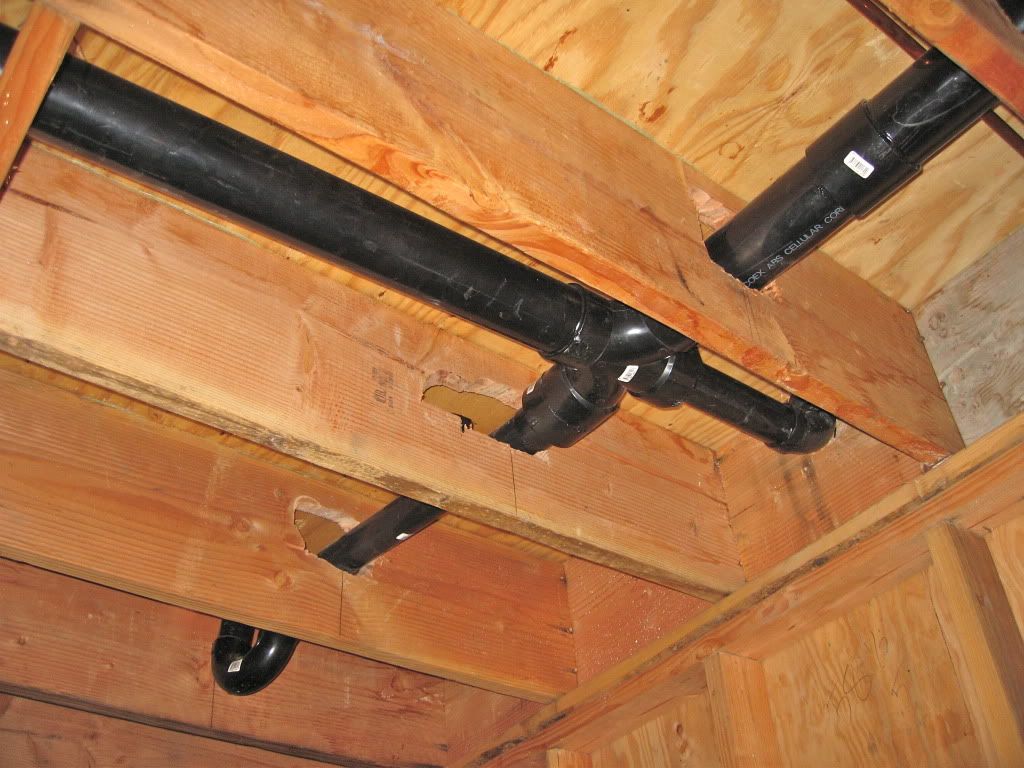

Was this done by a plumber?
13,891
How about you plumbing? Does the fitting in the middle look ok?
Jobsaver.....no tees on horizontal......for drainage.....ever....(that I am aware of) then doubles applies on vertical with proper install...
Wow! That is wrong in too many ways. It looks like the extra room was because they had to wedge the pipe in at an angle and needed the extra space to slip it in.
