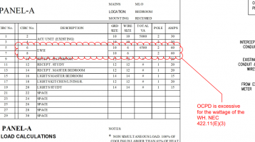

I just caught this one in plan review and though I would add this as some trivia. Here is the situation.
Level 2 remodel of condo which includes a new water heater
The panel schedule showed the following:
A double pole 60A breaker with #6awg cu wire to a 4500w electric storage water heater.
What is the NEC violation? Cite the code please.
334.80 says that NM cable shall be sized according to the 60 degree C column (310.16), which allows 55 amps on a 6AWG wire.
422.11(E)(3) says the branch circuit for a storage type water heater shall not exceed 150% of the device's rated current if the overcurrent protection is not marked.
4500 watts / 240 volts = 18.75 amps. 18.75 amps x 150% = 28.125 amps.
They need a 30 amp circuit maximum.
2020 NEC
2020 NEC
B I N G O
Since this is a condo, high-rise, however, there is no NM cable and more than likely this is in EMT with THHN.
