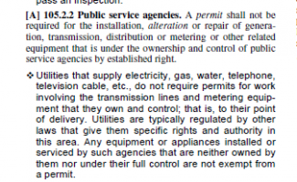

Should a permit be required or accepted for a utility owned water tower? I can find no applicable code or reference other than this:
"Public Service Agency" is a little grey, but I would think a municipal water supply would be considered one.

I disagree, water tower are structures and not exempt from section 105.2 number 5. Section 105.2.2 commentary "do not require permits for work involving transmission lines and metering equipment" a storge tank is not metering or a transmission line.
Cell and radio towers require permits. My opinion is, while a water company may be a utility it is not the same as electrical poles.
Unless the state agency such as the Department of Public Utilities has a specific exemption water tank is an elevated structure that could fall down and hurt someone a building permit is required.
(Add) 105.2.3 Public service agencies. Pursuant to section 29-282 of the Connecticut General Statutes, a
permit shall not be required for the installation, alteration or repair of generation, transmission, distribution,
metering or other related equipment that is under the ownership and control of public service agencies by
established right.
