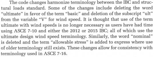

"Terminology describing wind speeds has changed again with ultimate design wind speeds now called basic design wind speeds."
Oh My. Just last week, we in Ohio changed to the 2015 IBC and we are grappling with the change from basic wind speed of 90mph to ultimate design wind speed of various speeds depending on the importance of the building.
Why do they keep changing this stuff?
AND, they have changed the size/shape and location of some of the special wind regions in the 18. I spoke with ICC to try and confirm this, but they referred to the ASCE. I reached out to them (specifically the person who authored the code change)............crickets in response. This is important for us, by the previous codes, we were in the special wind region, by the new illustration, we are not. The ASCE website has not been updated to the new ASCE-7, so it is no help either. I looked for guidance on this from ASCE and they basically said to buy the new ASCE 7 and watch for updates to the website. I get calls weekly on these wind change issues from engineers, I would feel a little inadequate, but they can't figure it out either.
