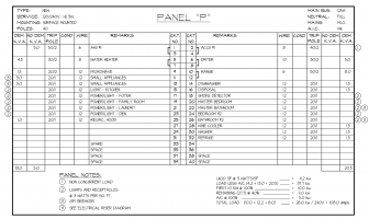

What is wrong with this?
(1) SABCs should be 1.5 kVA each.
(2) K111.6 requires that the smokes be on a lighting circuit. But if the dwelling unit meets the scope of 101.2 Exception, then the IBC wouldn't apply, and we'd have to check the IRC for an equivalent requirement. I don't believe the NEC has such a requirement.

Excellent. First reply gets it. Nice!
Seems odd that the panel would be surface mounted in a dwelling unit. Also note 3 calls for GFCI breakers, where is the note calling for AFCI breakers?
Those are excellent observations. This is typical of cut and paste by design professionals of record. I can guarantee you that the panel will be flush mounted and the panel schedule won't look anything like what is on the plans as this is an existing unit. This is in a condo so it is not 120/240, it is 208. We can reject this stuff all day long or just approve it and trust that the inspectors will catch everything in the field. This is an example of the laziness of the design professionals and common on 99% of projects.

Should the fridge and wine cooler count per 220.82 B as part of the calculation? Seems like an arguement could be made either way
The wine cooler is most likely fixed in place while the refer is cord and plug. That is truly "either way"
I wouldn't fault them for overdoing things such a 3 kVa for SABC and a refer. I suppose 0.33 amps deserves to disappear given that fat thumb on the scale but I would still fault them for rounding down on the total load.....admittadly, I have bad habits.
