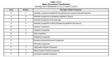

The homeless shelter has several private bedrooms and some with bunkbeds, common living areas, kitchens, etc. Each floor has staff 24/7. no treatment.
I'm going for a B3 - Care occupancy
How would other AHJ classify them?
Thanks

I believe B3 is the correct choice. I think it is a very similar facility to assisted or supported living.
I'd not consider this a B occupancy. I'd go for a C = residential. What's the difference between this and a hotel or a hostel? None, really.
B3 is a particularly restrictive occupancy classification, with sprinklers, part 3 engineering, etc. I highly doubt there is any care taking place, so it doesn't meet the test of a care or custodial.
I'd call it C. 45-min fire seps as required, alarm if more than 10 people.
I was thinking B3 because many of the occupants will be dealing with physical disabilities, mental health and addiction issues, much like a supportive housing situation.
I can also see residential because it has similarities to a dormitory.

Physical disabilities would be addressed through NBC 3.8 (or regional equivalents*) to provide at least one barrier-free suite if there are more than three/four* units if at ground level or accessible by elevator, and if so kitchens, and some bathrooms - including showers - would need to be barrier-free in a C occupancy.
IF there is no treatment being provided, it's not a B occupancy. If it's a supportive housing situation, then yes, B occupancy. That's up for the client to declare.

Good stuff guys. It seems homeless shelters could be either B3 or C.
The building i've been referring to is a BC housing facility that could fall under part 9 if of C occupancy. occupant load is higher than 10, and a 1hr fire separation with a small D occupancy (A2 restaurant under 30 occupants)
Reading BC Housing's website on "supportive housing", It describes the type of services offered. https://www.bchousing.org/housing-assistance/housing-with-support/supportive-housing
1690383714581.png Thanks for the input gentlemen
I just realized: it might be worth reading 9.10.2.2 in NBC 2020 to see where the Code is going on such things. 9.10.2.2 essentially relaxes some small flavours of care occupancies to move them out of Part 3 (ie: B) into C (part 9) occupancies.
Would also be worth checking in with your OFM on how they treat these things.
The real crux of these issues is the level of self preservation of the occupants. This is both from a cognitive standpoint (do they understand that there is an emergency and what they should do) and a physical standpoint (can they move under their own power to the exit).
The question to answer is: in an emergency, what do the staff do? If they just leave, then you have a C occupancy. If they need to go room to room and make sure everyone has left and help those that have not, it is a B occupancy.

I agree. So where would you put the homeless shelter?
If it is "just" a homeless shelter, I would say C.
I would only go with B if they are specializing in cognitive issues or people with severe mobility issues.

Seems we agree that part of the determination between B3 or C for a homeless shelter is to be determined on a case by case with the applicant.
