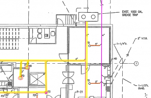

Maybe I'll post an example with a diagram for greater clarity.
Below is a semi-randomly selected diagram for under-slab DWV that I found in an image search. If all the black lines shown are horizontal, under the slab and sloped at 1/4" per foot without any vertical offsets, it seems to me that everything shown falls in the category of "building drain" per the definition.
If you disagree, please indicate what specific part of the definition or other IPC requirement for the building drain would exclude any of the drains in the diagram from being part of the building drain.
Cheers, Wayne

I should have said 'credit' rather than 'point,' because I was saying the ways in which I agreed with the both of you.
As for the diagram you shared, if we view the IPC through the comprehension of the nature of building drains I outlined, then the distinguishing factor between horiz. branches and build. drains is sizing in terms of DFU allotment for the latter (B.D.'s) to have a cross-sectional area which permits air flow as well as waste/soil tansmission. In which case, provided there is proper venting, none of the drains from any of these fixtures needs to be designated (and therefore over sized) as a building drain except where the drains depart the building's footprint on the north side, near the clean out - as the code states, from 30" to the exterior wall, at which point it becomes the building sewer, because it is self-venting all the way to the public sewer. They *can be*, but then they would be oversized for the application.
Does that make sense? I'm saying in the spirit of the code rather than the letter, that I think the job of the codes for venting are to get enough airflow down to where the DW becomes building drain, so that it can self-regulate from there, provided the DFU rate is to code for the fixtures serviced.
Humble regards, AsclepianDreamer
Well, if your proposed explanation says that (almost) none of the drains in my diagram are the building drain, and the letter of the code says they all are, then your proposed explanation doesn't match the letter of the code. That doesn't necessarily mean your proposed explanation is wrong, it just means that if it is correct and complete, the code writers did a terrible job of writing the definition of "building drain."
For your proposed explanation, I'd write the definition of "building drain" as something like "That portion of the drainage system that is either outside the footprint of the building but within 30" of developed length from the footprint of the building, or at the lowest level of piping within the footprint of the building and more than X feet of developed length from any connected vent." For some value of X.
But so far in this discussion I'm at the stage of the analysis of "do we agree on what the letter of the definition says?"
Cheers, Wayne
