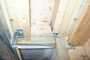

What's with all the sill plate issues?
Looks like the “horizontal “ board was supposed to continue further to the right, which would have better covered the anchor bolt.
Sorry mark, I don’t think thats a shot. I think its an anchor bolt that’s too short, so the nut us only in a couple of threads.
