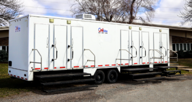

I have a homeless services (Homekey) hotel conversion project in California where they are trying to move residents in now, before the permanent resident laundry room if finished 3 months from now.
They are intending to rent an all-in-one laundry trailer. See example below. It would be placed in the parking lot, using several parking stalls.
It has a vehicle license plate and is roadworthy, kind of like those restroom trailers they use on movie sets or country weddings. The laundry trailer has its own propane supply and grey water tank, just like an RV - -all it needs is a power hookup and a hose connection.
  • The city building official is calling it "temporary construction" per CBC 3103, requiring either a full plan check; or else an HCD modular tag, foundation (auger) plans, and access ramp plans.
  • I contend that because it is licensed by the DMV as a "trailer coach" (like a travel trailer) it is not subject to the building code at all, and can be parked like any other RV - - no foundation needed, no plan check by the building department, and thus no property line setbacks (because vehicles are allowed to park next to the property line).
Who is correct?
Do you think that it could pass a plan check? The stairs alone would kill it. Has the Division of State Architect approved the trailer?

We would probably require at least a permit and drawings for an accessible ramp & landing with guards/handrails & some sort of anchorage. The trailer my be a vehicle but it is being used by the public and being used as a temporary bldg. and should be accessible. We also require landings, handrails & anchorage for MH placements. So basically treat just like we would a manufactured home.
If it has a license plate then it has a registration as a trailer and I have no jurisdiction over it
Electrical permit for the connection and I would need to know where the propane tanks are located

I guess what I'm saying is: You don't plan check a motor home when it sits in a driveway, right?
It's regulated by the department of motor vehicles.
OK, now let's say that motor home hooks up to 110 volts on an exterior electrical outlet, and hooks up to a hose bibb.
At what point does the building official plancheck it? For example, after 30 days of it sitting in one spot, do you start treating it like a structure instead of a vehicle? If so, is the authority to treat it like a structure found in your adopted building code, or your municipal/zoning code?

We've had this discussion internally. At no point does it become a building subject to regulation by the building code.
As soon as it is no longer licensed we will designate it a derelict vehicle and deal with it under our Dangerous and Unsightly By-law.
Otherwise it can stay there forever. We found that any other approach has some issues with consistency.

Thanks Mark, but that thread appeared to be more about a modular like this, that is towed to a site and placed on jacks for longer term (>180 days) use:
My question is, would you require the same kind of permit and plan check for a short term trailer, like this movie location restroom vehicle?
