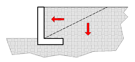

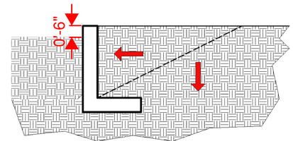

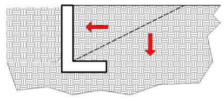

Without a soil report, the typical assumption is that a surcharge load goes through the soil and wall at a 45 degree angle. so if you have an 8" thick wall, retaining of surcharged loads starts at 8" of elevation difference.
