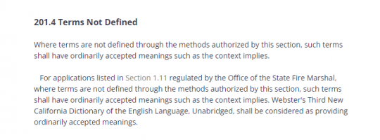

I’ve been looking online, but can’t find the dictionary referenced in the California Building Code chapter 2, as quoted below;
"201.4 Terms Not Defined
Where terms are not defined through the methods authorized by this section, such terms shall have ordinarily accepted meanings such as the context implies.
For applications listed in Section 1.11 regulated by the Office of the State Fire Marshal, where terms are not defined through the methods authorized by this section, such terms shall have ordinarily accepted meanings such as the context implies. Webster's Third New California Dictionary of the English Language, Unabridged, shall be considered as providing ordinarily accepted meanings."

Looks like a typo.

2019 CBC, section 201.4 says "International", not "California".

As stated before, a typo

Check with the Building Standards Commission
BSC referred me to the State Fire Marshal, where I got this reply today:
"Unfortunately, that code section was amended a long time ago. We plan to repeal the amendment for the 2022 Intervening. The next 2022 edition of the California Building Code when it is published in July with have this error fixed.
The intent is for the Webster’s Third New International Dictionary, Unabridged to be used https://shop.merriam-webster.com/products/websters-third-new-international-dictionary-unabridged
There is a printer error. The general rule for the printer is to replace where “International” is called out to replace it with “California”. In this case it is an error.
I Hope this information helps."
