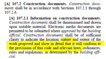

Depends on the intent of the resubmission. If it is to show the plan reviewer why the detail is correct, thats ok. Probably better done in a sit-down meeting. Go through all the “corrections” , agree which are acceptable, then submit clean drawings suitable for the knuckle-dragging apes on site.What are the feelings out there when revised drawings are returned for re-review now with narrative paragraphs headed by code section numbers instead of drawn plans, sections, and details?
That is one of my "favorite" comments to hear.... as if that has any bearing.You know the plans are already out to bid, don't you?
