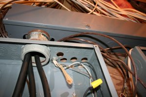

Even with commercial work, you see the lack of workmanship and simple understanding when you place a lug plate over the top of exposed screwheads which cuts down on the surface to surface contact and leaves the plate tilted at an angle. Again, more substandard electrical work found in Pennsylvania.

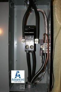

Look at this picture of a service upgrade that was done by a licensed electrical contractor. I can surmise that they knew what was wrong but took a chance that I would approve it. Why? What makes them think that it could pass an inspection. It must be complacency......they are banking on me being a lousy inspector. Such inspectors are out there. Apparently in numbers sufficient to approve lousy work.

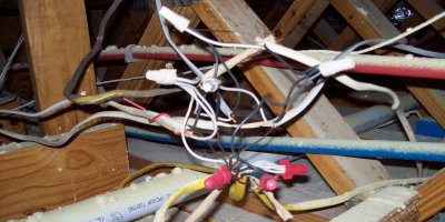

It is not unique to the electrical trade. The mechanical contractor that did this must not be used to thorough inspections.

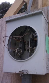

Complacency....a contractor installed a service upgrade and the person that met me was the guy that patches the stucco. He was surprised that I wanted to see inside.......because? Draw your own conclusion.
