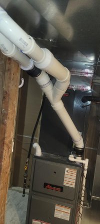

Furnace replacement where the existing vent going above a finished ceiling was too small for the new furnace. Instead of doing it right and resizing, their solution was to turn the original combustion air pipe into a second exhaust. They told the owner to keep the furnace room door open all the time.
This was done out in a rural area out of my jurisdiction where no permits or inspections are required for HVAC. The work was done by a contractor licensed to work in our jurisdiction. Another much more reputable contractor was called to fix it because (shocker) it wasn't working right. He sent me this picture to give me a good laugh and add to my !!! file.

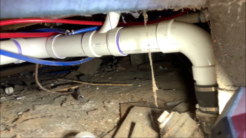

Happens all the time. Someone in our jurisdiction hired an unlicensed contractor (lastname construction, the owner assumed they were licensed and pulled a permit) to remodel a small house. The contractor gutted the place and installed plumbing and electrical without a license. The 90 at the right of this picture is actually reducing a 4" line down to 3" to tap into the existing sewer. Almost all of the plumbing upstream is 4". Which means that everything upstream had to be replaced with smaller pipe to make the existing sewer work. The longsweep san-tee is pointed back upstream. The plumbing was sloped properly, but my camera was not so it looks bad. The Furnco is not shielded per manufacturer for above ground application.
The electrical in-wall had already been covered, and if a guy can butcher plumbing this bad, I was not about to trust his electrical. Drywall was removed. The owner had to hire licensed contractors. He had already paid the unlicensed guy, so he ended up paying for everything twice.
